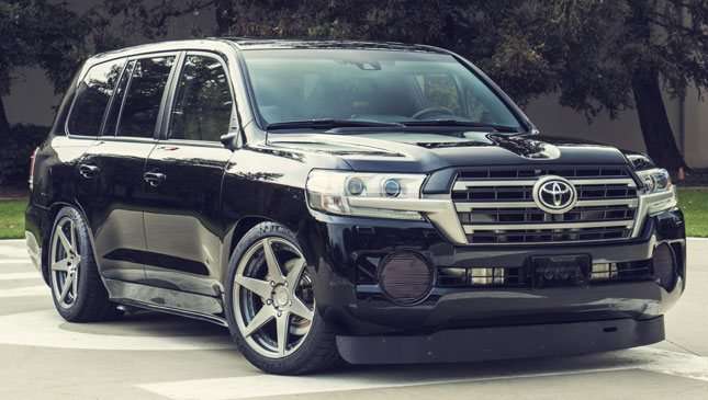

So Chuck’s team have set about fiddling with the Land Cruiser’s standard engine. In the US, that means a 375hp 5.7-liter V8 powered by gasoline which yields a 229kph top speed. Some way short of 340kph, then. So Chuck and his engineers are looking for power. Much more power. “Calculations show us 1,900hp will get us to the speeds we’d like to attain,” he tells us. “And the engine—as in the block and everything except the head gasket—is built to go to around 4,000hp. But with everything we’ve got built into it now, we’re probably going to be limited to about 3,000hp. Which is still good power. It can get you to work on time!”
The biggest change to the engine is its new turbos, which sit behind those gaping intakes sitting below each headlight. Described by the team as ‘volleyball-sized,’ they’re ball-bearing turbos made by Garrett, able to provide up to 55psi of pressure.

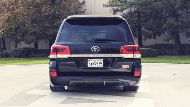

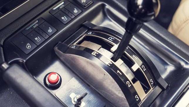

The Land Cruiser’s standard automatic gearbox has gone, replaced by a drag-minded three-speed gearbox with an overdrive. It’s built to handle 3,000hp. Chuck has fitted a Weissman Locker differential—“a bitchin’ diff,” he affirms—while the suspension is from Toyota’s aftermarket TRD team. It’s been revalved and resprung, while the car, you’ve no doubt noticed, sits around five inches lower than standard. Peer beneath and the exhaust setup is practically a work of art, though for the high-speed runs, there’s a clean underbelly panel fitted to aid aerodynamics.

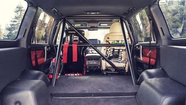

You might have guessed the aero would need some work, but it’s also the area with some of the quickest gains. There are cameras rather than wing mirrors—“we don’t want elephant ears on the side of the car,” says Chuck—while the rear spoiler incorporates an adjustable Gurney flap. Getting the Land Speed Cruiser’s center of gravity as far back as possible has been key, because the front driveshafts have gone. This Land Cruiser may have eight times as much power as standard, but it’s rear-wheel drive only. Yikes.
It doesn’t weigh any less, even though the interior’s been trimmed down and the back seats removed. “It’s a 6,721kg vehicle still. We didn’t save weight. We didn’t make a race vehicle. It’s 2.7 tons full of fuel oil and driver. That’s good for traction. The real neat thing about its tires (Michelin Pilot Supersports) is that in their normal application, they’re run under a lot of downforce, so they’re built for weight.

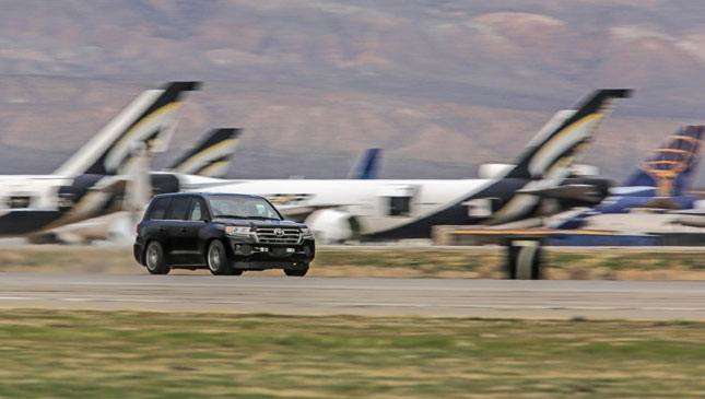

Fast forward a couple of months and Chuck’s pride and joy is at Mojave Air and Space port. The runway is 5km long. The team has split this into 2.4kms for the Land Speed Cruiser’s acceleration, and a whole 1.6kms for braking. Racer Craig Stanton is the driver tasked with ‘warming up’ the car ready for its record attempt.
Every single movement is super critical,” he says. “Spending three seconds coming off the throttle, spending three seconds transferring to the brake, so you’re super smooth and not dramatically transferring weight around the car.
“The first time I drove it was all-wheel drive and super stable. Then it was turning to rear-wheel drive and I was thinking ‘how’s this going to work? Is the back end going to step out with all that power, will the back just want to pass the front?’
“Then at our proving ground it was hitting almost 306kph! I could steer it and change lanes; 2,722kgs with a bit of aero, and it didn’t do anything funny or strange or out of character. And once you get onto the straightway at 306kph you have a head start.”
With an almost movie-like plot, the team’s chance to top 340kph doesn’t come until the very last run of the day, with only a small amount of the Land Speed Cruiser’s ethanol/fuel mix left. It’s fair to say the 118L tank has been emptied several times in the run up to its run.
The record run’s stunt pilot—recently retired NASCAR driver Carl Edwards—spookily sets 340kph on his first run, with barely an inch left for slowing the big Toyota from any higher speed. Which is where having a power figure so short of the engine’s limits suddenly seems a very good idea. With the boost pressure of the turbos raised, power can edge up from 1,900hp and Carl can hit a higher speed earlier. And he does exactly that, recording 370kph with braking room still to spare. It’s a script worthy of Hollywood.
