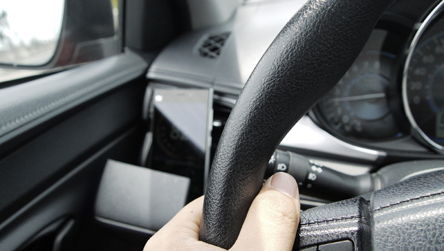

For those looking for a good app, we used Ulysses Speedometer. There are other apps out there, but this one has a nice, snazzy readout and an easy-to-configure display, as well as total moving time and average-speed calculations. We stuck it in the cupholder in front of the A/C to keep the phone cool, glancing at it from time to time to check our speed. As you can see, the onboard speedometer was a bit off, as all stock speedometers are.

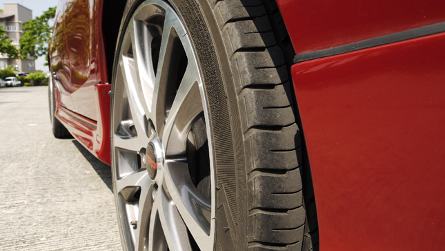

While the heavy TRD wheels and 205/45 R17 tires hurt both performance and economy, the extra height helped claim back some economy on the highway, where they dropped cruising engine speed by 100rpm.

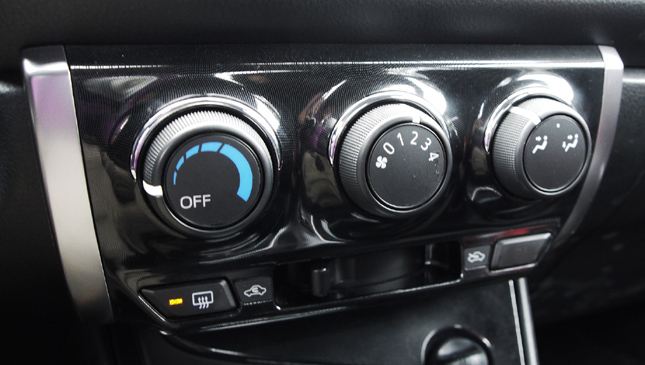

Yes, we kept the A/C on--fan set on 2, and thermostat on its most economical setting. Didn't break a sweat! The Vios's new A/C is pretty powerful.

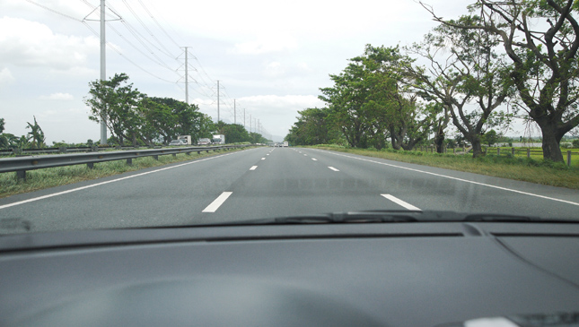

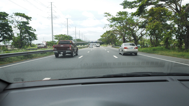

Thankfully, traffic conditions were nearly ideal. The runs were conducted at 80kph, dipping no lower than 75kph going up each slight rise, and going no higher than 85kph coming down the other side. As much as possible, we didn't draft trucks. If there was a truck in front of us, we either drove one lane over or overtook, as slowly as possible without impeding traffic.
Aero-Vios experiment
We kept mostly to the middle lane in order not to impede traffic. By the last run, congestion had built up, making the trip a few minutes longer than the others, so we had to scrap that one and call it a day. The data collected was interesting, to say the least.

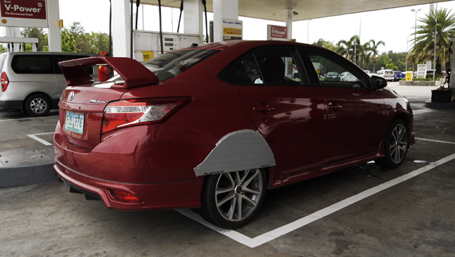

That said, the wheel covers, of course, provided extra benefit. For an idea of how much air goes through the spokes, one of our covers actually billowed out and flew off on the highway! It's a good thing it was made of rubber. The safest way to add flat covers to your wheels is to use commercial wheel caps, and to tape over those. Leave a space for the tire valve, though.
Aero-Vios

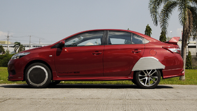

It's also important to note that the 17-inch wheels poked out of the bodywork more than the 15-inch ones. Thus, our flat hubcaps and rear wheel skirts had a bigger effect here than on the standard car.
And, best of all, they helped keep those nice, shiny wheels from getting scratched. Considering how much TRD wheels cost, that's a good thing.

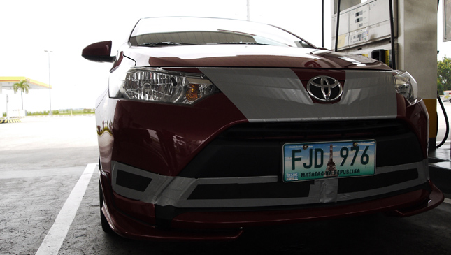

As a word of warning, if you're going to experiment on your own car, do know the risks. Covering up too much grille area can lead to overheating, and having loose pieces of body work attached to your car can be detrimental to your safety, so tape wisely. Also, duct tape is difficult to remove from paint, so it pays to wax the car thoroughly before attempting this on your own.
