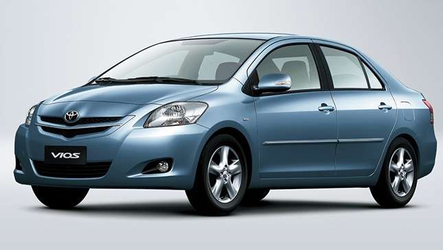

I drive a second-gen Toyota Vios E. I am wondering if a delay between depressing the gas pedal and the engine response is normal (roughly 0.5 seconds). It's not a big deal on flat surfaces, but having to stop on inclines leaves me uneasy.
I have consulted a mechanic about it and they cleaned the throttle body. Sadly, this did not solve the issue. My gut tells me it's something electronic, and reading several articles and forums strengthens this belief. Some forums claim that this is normal for a drive by wire system, but I have driven other cars of the same system and the response is instantaneous. I have also tried an ECU reset with no results.
I have already inquired in Toyota Alabang about the problem. Unfortunately, they need two days of diagnostics to find a solution and I feel uneasy about leaving my car after reading horror stories regarding casa jobs.
My odometer is at over 90,000km and the car has been regularly maintained.

It's been a while since I last drove a Toyota Vios 1.3 E in either manual or automatic transmission, but I think what you are encountering is normal for vehicles with smaller engines. If memory serves me right, the 1.3 liter NZ-FE  that powers the Vios puts out about 84hp and 120Nm of torque at their respective peak RPMs; decent for an engine of that size.
If I also recall correctly, like most cars with small engines, there's a bit that's left to be desired when leaving from a standstill. I have to be really smooth engaging the clutch in a manual while applying a good amount of throttle to get going quickly, and flat out enthusiastic stepping on the pedal in an automatic variant—more so when on an incline or fully laden.
Combine the low power output at that rpm range with an electronic throttle that's primarily been designed to ensure that the engine will be economical, and you've got the conditions that may likely be the cause of the delay you're encountering.
So, is there something wrong with your car? I'm not so sure. Unless the delayed response is something that happened fairly recently and your car wasn't like that before, I wouldn't worry about it much.
However, if it wasn't like that before and just abruptly became so, I would then want to have it checked.
