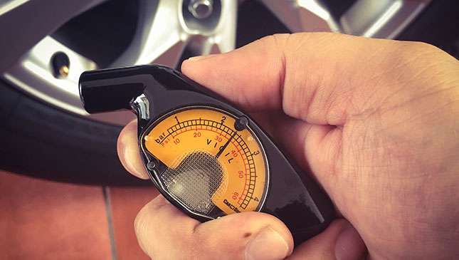

Most people will visually perceive almost any passenger car tire to be low on air. The fact is, very few people can tell just by looking at the sidewall of a vehicle's tire how much air it has. Even seasoned mechanics won't be able to easily tell without the use of a tire gauge.
Generally, the way a tire looks when it is inflated within 5psi of the manufacturer's recommended tire pressure looks no different to one that is properly inflated. No amount of wishful thinking will change that fact.
Any given tire will have a certain load rating for a given amount of air in it. If you've read the owner's manual or the tire label on the driver door jamb, you should've have noticed that there is a different set of recommended tire pressures when the car is fully laden and when it is carrying only a couple of passengers. The recommended tire pressures for the given sizes outlined in the owner's manual will be the best possible for most driving conditions and motorists.
Some car enthusiasts may choose to play around with tire pressures by deviating from the manufacturer's recommended levels by adding or reducing the amount in order to achieve their own ends. Be aware that when you do that, it is at your own risk as altering tire pressures will affect load capacity, tire traction, braking distances, and handling. Should you decide that you want to do this, buying a quality tire gauge to monitor your tire pressure is a must. The brand or type doesn't really matter as long as it will always read consistently
