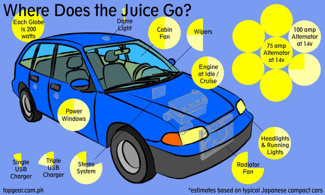

Is it too much of a draw? Many modern alternators produce between 75-100A. Amperes are a measure of electrical flow, while watts are a measure of power, or the rate of electrical work. To convert, we need to know the voltage. Think of voltage as the pressure inside a fire hose, amps as the speed of the water being pushed by this pressure, and watts as the amount of energy coming out the end. Enough watts, and that water will knock you off your feet!
To convert amps to watts, you multiply 75A by the 12V of your standard automobile, and you get 900W. And when the battery gets low, the alternator goes into charging mode, recharging at up to 14.5V, boosting that output to 1,080W. More than enough for a dinky charger!
Of course, your smartphone charger isn't the only thing drawing power from that alternator. Let's tally up everything else that does, then:

Note: These are ballpark figures, and may vary per car.
Those of you with worn-out electrical systems will not be surprised at how much electricity power windows use. This explains why the lights dim when you press all four window buttons at once! Otherwise, it's plainly obvious that the Tronsmart charger is a drop in the bucket compared to what's already on the car. Using it with the engine off is no worse than listening to the radio while parked. It will take a few hours to fully drain your battery. And if you are only charging one device, the load will be closer to 10W than 42.

ILLUSTRATION: Niky Tamayo
