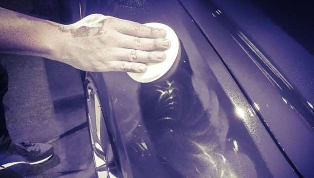

4) Applying a thick layer of wax. Aside from being wasteful, a thick layer of wax won't make your car any shinier. In fact, it will just increase your effort in buffing it off, which is something I shy away from. My approach to buffing is always accompanied by a high degree of finesse and subtle pressure. Too much force on the surface can be unkind to your clear coat and possibly dent your panels, given that a lot of mass-produced cars today use thinner sheets of metal.
What's right: The best way to achieve the best coverage and shine is by applying a thin layer of wax in even, circular strokes working on one panel at a time. Allow a couple of minutes for the wax to dry to a light haze then buff off. For extra protection, you can do a double wax by simply repeating the aforementioned steps. When possible, you should use a nano-shield synthetic wax for the first layer followed by a show car wax to top it off. It’s a powerful combination of shielding your paint from pollutants and the elements while achieving a shimmering, show-worthy finish.

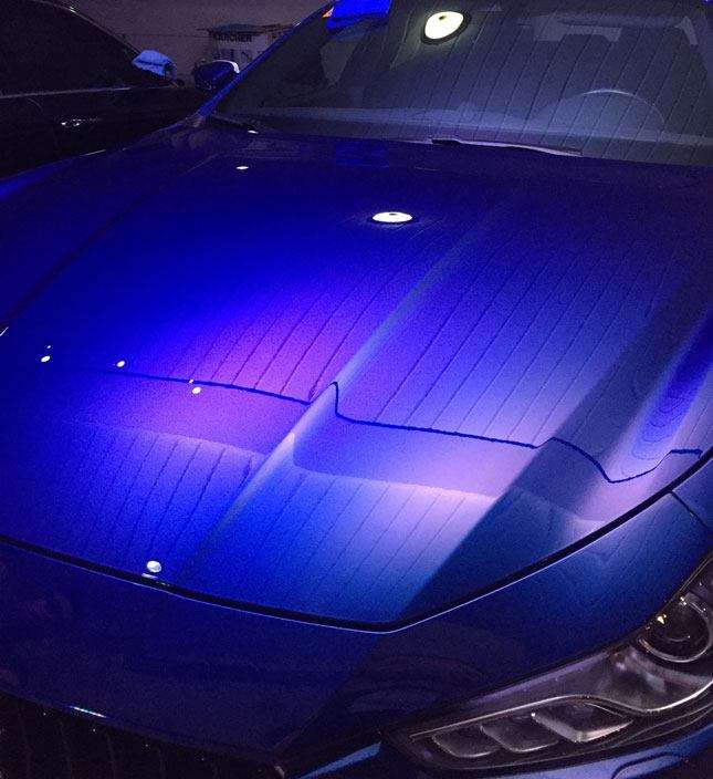

6) Using the wrong wax type for a specific paint condition. Thanks to modern technology, we now have a range of waxes to address different paint conditions. Typically, most of us (shops included) won't know this, so it's best to consult professionals in the industry or educate ourselves by asking Google.
What's right: Don't use a show car wax for paint that's been neglected. Instead, use a carnauba cleaner wax as it cleans and protects at the same time. When the paint is in better condition from being detailed properly, then you can switch to a show car wax.
