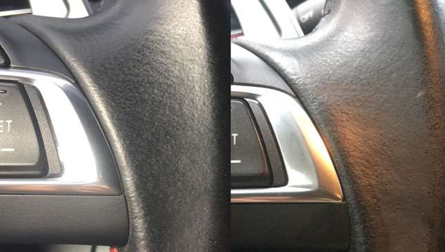

*Always start with a pH-neutral leather cleaner and a soft microfiber towel. Say you have embedded dirt or grease on your leather-wrapped tiller, seats and sidings, this approach is by far the simplest way to bring back that fresh, clean look. When dealing with dark colors, always do a spot test in an inconspicuous area first to check for colorfastness. Spray cleaner onto a towel then wipe down affected area, especially if you need pinpoint detailing like in the case of your steering wheel. Have a second clean towel for drying.

Now that your leather feels like a baby’s bottom, you can finish the job with a leather conditioner that will retain the suppleness of the material and resist wear for many days to come.
PHOTO: Manskee Nascimento
