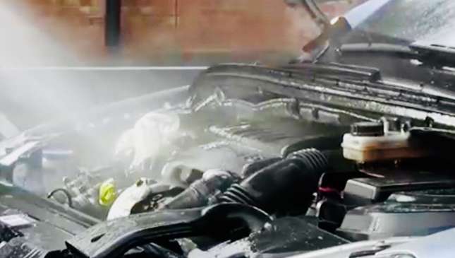

The common way to get that motor cleaned up is with an engine wash—a popular service given by most car wash shops. It’s pretty affordable (P100 to P500) and usually takes an hour or less to accomplish. The pressing question is, is this method safe for your car?
Well, the idea of hosing down a bare engine with pressurized water does worry me, especially when dealing with today’s tech-filled engines. Though some decent shops tend to cover areas like the computer box, ignition coils, distributor, tranny vent, battery terminals, fuse box, airbox intake, etc., it isn’t a guarantee that water won’t creep into these sensitive electrical/electronic parts and cause damage, corrosion or hamper performance. Issues may arise immediately after or even months down the road.

Allow degreaser to settle and loosen all the gunk for a few minutes, followed by spraying these areas down. Use the toothbrush for the tougher stuff, especially in tight spaces. Ensure that spray nozzle is adjusted to create a more gentle, less concentrated stream of water. The rule of thumb is if your hand could handle the pressure without any discomfort within six inches of the nozzle, you are good to go.
The old practice of some shops is to use harsh soaps and solvents such as kerosene or gas to clean out the engine. In addition, they hose the engine down with way too much pressure. Honestly, I find these methods highly risky and can cause adverse effects on some parts. Strong solvents can also make plastic or rubber portions prematurely fade and become brittle.

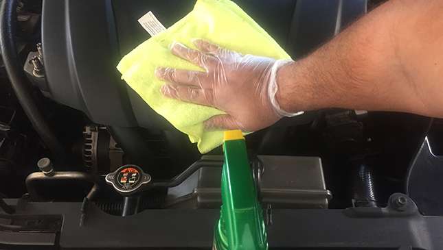

Once you’ve sprayed off all that gunk, it is time to dry out your engine. With a clean set of absorbent microfiber towels and a blower/compressed air, draw out moisture from all areas before removing parts covered with plastic bags. To finish off all areas, use a detailer spray followed by protectant for rubber and plastic trim. This step prevents water stain accumulation on both painted areas and composite materials. When cleaning the uncovered sensitive areas, spray detailer onto the towel first then wipe down thoroughly and carefully. Always be aware of your engine’s wiring and electrical connectors. Treat these bits very gently.

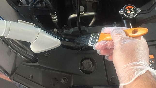

This method of cleaning an engine is something I’ve employed for many years and is a waterless process. Though it takes more time and patience, the risk involved with a wash is greatly reduced.
In addition to having the materials mentioned in the wash, minus the plastic bags, tape and pressurized water spray, include a powerful vacuum, vinyl gloves and cotton buds to your list.
After putting on gloves, work your engine slowly and surely one small section at a time until every nook and cranny is detailed. Carefully vacuum surface areas as you dust with a dry paintbrush. For the tight spaces your fingers and brushes can’t reach, the cotton buds should be more than capable of doing so. When detailing overlapping components and parts, soak a towel with detailer and wipe down. Use the degreaser only when the detailer spray can’t hack it.
