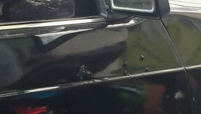

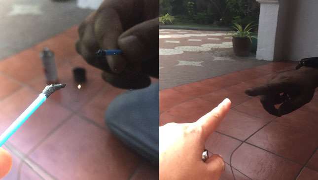

Example: I recently acquired a rock chip on one of my door panels from a construction site (seen in photo above). Judging from the depth and color, the blemish went all the way down to the primer. Given I take great care of my car and the rest of the panel was in exceptional condition, it would be impractical to do a repaint of the entire panel to rid it of this tiny issue (though the psycho-emotional pain was incomparable in magnitude). The sensible approach was doing a touch-up with a bit of paint I kept for instances like this. It turned out pretty well, in my opinion.

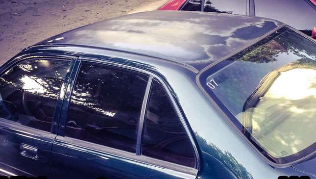

* Clearcoat condition. For everyone’s information, your clearcoat or topcoat is the 'epidermal' layer of your factory finish. It protects your base paint and brings it to life. Sadly, your clearcoat will thin and erode with time, usage and exposure to the elements. Once it goes, you’ll start seeing what appears to be a formation of maps on your painted surfaces, a clear sign that the clearcoat has withered away, subjecting your base layer to the damaging effects of the environment. No form of detailing can save your paint or bring back its shimmer at this point. This is where a hilamos comes in.
Once your clearcoat has been obviously compromised, it is now time to schedule a proper repaint. Depending on where you go, a reputable shop could charge you anywhere between P4,000 -6,000 per panel or P35,000-50,000 for an entire sedan; sometimes more if you go with more layers and depending on the paint brand you choose.
