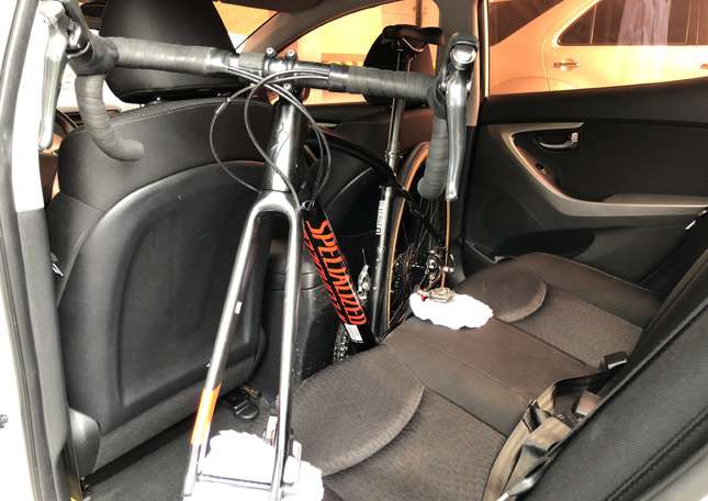

1) Make sure your bike is reasonably clean before you stick it in there.
Wet Wipes are your friend. Wipe off any crud on the frame and tires so you don’t get Gatorade, mud, manure or snot on your upholstery. Muddy bikes are a no-no.
2) Remove the front wheel and store this in the trunk.
Make sure you don’t slam the trunk hinges down on it.
3) Put the chain on the small ring.
To lessen the chance that you’ll get grease on the back of the transmission tunnel thingy.
4) Gently place the bike on the floor, non-driveside facing the seat.
Position the left pedal at 12’o clock to stabilize the bike on the backseat. Place a clean piece of cloth under the pedal to avoid staining the seat.
5) Place another piece of cloth under the fork dropouts.
To prevent these from puncturing the seat.
6) Size matters.
This technique works for most road and time trial bikes, and Small to Medium sized mountain bikes, fatties and +Plus size not included. You’ll need a proper external rack for those.

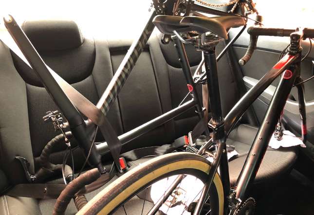

Got two bikes to transport? It won’t be pretty, but it’s doable:
1) Put the gears of bike two in the small chainring and the smallest cog.
This is the easiest way to remove the wheels and to put them back on later.
2) If you have wheel bags, use them.
Otherwise, they go as is in the trunk. The rear wheel should be at the bottom, cog side down to avoid getting your spokes caught in the gears.
3) You can opt to remove the skewers.
Place these in a pouch if you’re fussy, but I don’t bother. Just make sure they don’t hit the rim or spokes of the other wheel(s) to avoid scratches.
4) Remove the bidons.
That’s Euro-speak for water bottles. Carefully place the frame upside down on the backseat, taking care to avoid your rear derailleur from touching the headliner. This actually violates Rule #49 ("Keep the rubber side down"), but these are mitigating circumstances as you definitely don’t want grease stains on the seat, do you?
5) Use the seatbelts to secure the frame.
In the event of a bad crash, you can rest assured that your babies will be safe from harm.
6) Consider buying a Yakima fork mount.
Own a Honda Jazz or some such wagon? Bolt these to a piece of wood around eight square inches for stability. You can now mount your bike upright in the back, with the front wheel removed.
Obviously, placing two bikes in your car means no more space for the kids. This setup is no longer kid-friendly, and if you plan to regularly transport more than one bike and three people, then a sedan is no longer practical. Get a pickup truck or midsize SUV.
