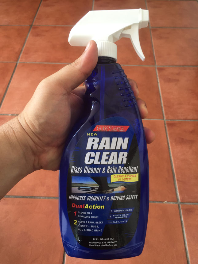

If your vehicle just rolled off the showroom, it doesn't mean that a glass detail should be shrugged aside. In fact, it's best to examine your windshield for whatever it may have picked up in transit from the factory to the dealership. I've always believed that prevention is better than doing a fix later on, so it is crucial you get a good start by keeping your windshield and windows spotless from the get-go. You'll find it easier to maintain from this point on as long as you use a good cleaner like Glass Science Rain Clear on a regular basis.

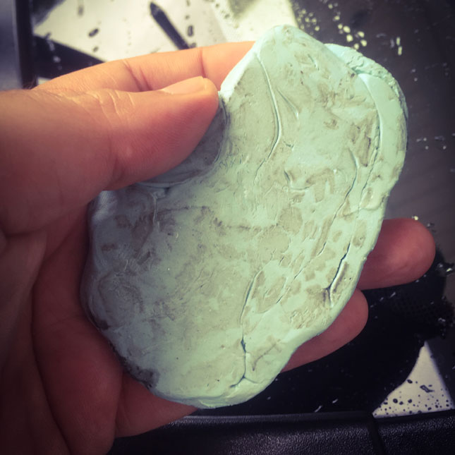

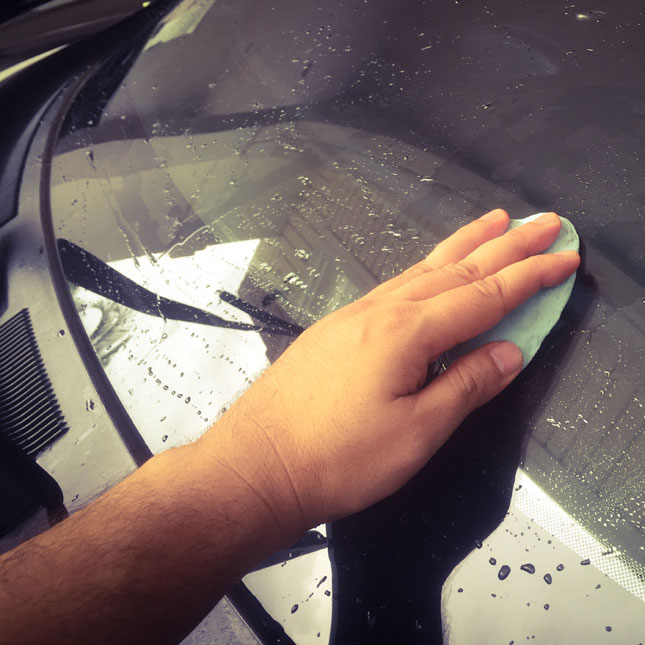

1) Claying. The use of a clay bar was something I picked up as I was learning to detail paint some years ago. Through experimentation, I later discovered that it is quite effective on detailing glass as well, and it turns out to be a very easy method. The only things you'll need are a clay bar made by brands like Turtle Wax (cheapest), Mother's or Meguiar's, and a spray bottle of glass cleaner or distilled water. Here's how:
a) Clean the surface of your windshield first before applying this method.
b) Knead the clay bar with your hands to make it more pliable, then flatten it out.
c) Spray the glass surface with cleaner/distilled water, then rub clay bar in a circular motion on affected area. Add light pressure as you do so, maintaining wetness on the surface. Clay should glide with ease. Once you start feeling it stick to the glass, spray on more cleaner/distilled water.
d) Wipe dry and inspect results.
e) Repeat when needed.
This works great in removing gunk and water marks.

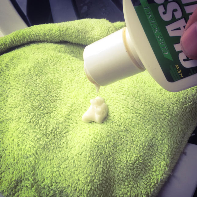

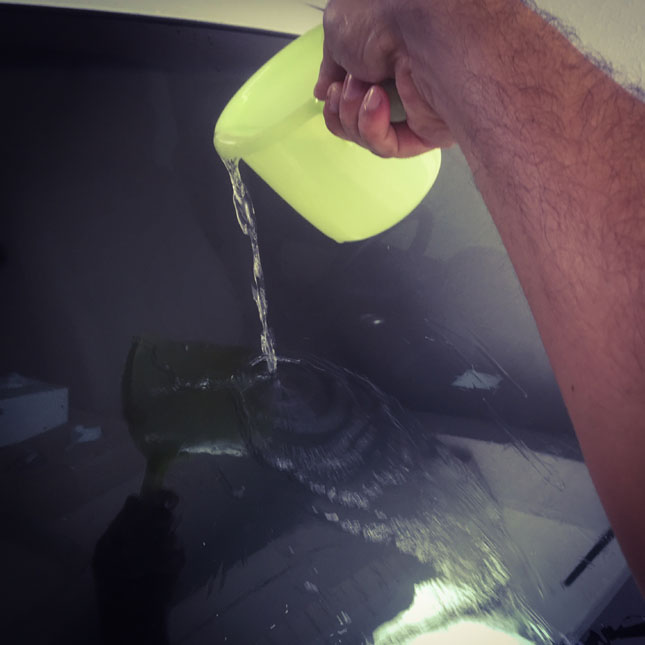

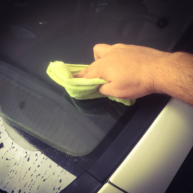

2) Glass scrub. Scrubbing can be used in combination with claying especially if the latter isn't removing the stains that have set in from years of abuse or neglect. Glass Science makes an excellent scrub. I find it safer than using compounds, which cause marring (rubbing compounds aren't designed for glass in the first place). Here's how:
a) Ensure you start with a clean surface.
b) Wet the area with some distilled water before applying product.
c) With a damp microfiber towel, squeeze in a peso-coin-sized amount then begin scrubbing away in circular fashion. Again, pressure should be mild. Never allow the surface to dry up while doing so.
d) Rinse off with water, and wipe dry with a clean microfiber towel.

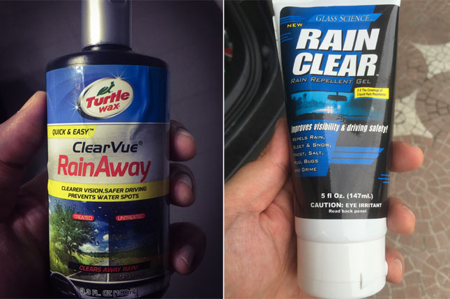

4) Water repellent protection. Once glass is in perfect form again, you can protect and increase its water repellent capabilities by using Turtle Wax Rain Away or Glass Science Rain Repellent Gel. Application of these products is pretty straightforward as long as the glass is all that's coming in contact with the product. When put to the test in actual driving conditions, I ended up not using my wipers as water beading was very evident.
