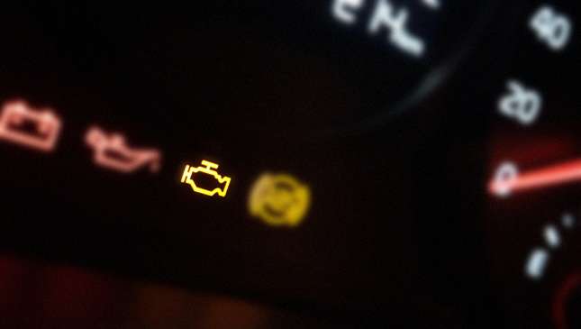

I own a Honda Civic 2007 FD MT. Lately the check engine light always turns on. When it starts from cold, there is no issue. But when I turn off the engine after a drive and then turn it on, it will take about 10 to 20 minutes to start. Long drives are not an issue.
I brought it to a Honda service center and was told that I need to have the top dead center (TDC) sensor replaced. I paid P6,000 to have the TDC sensor replaced, but the problem persisted. I was then advised to change the computer box or the engine control module, which is about P50,000 because they couldn't detect any other issue and there's a lack of supply of kuryente.
Do you have other suggestions? The computer box replacement is quite pricey, and I only know the car basics. Thank you for the help, and I hope you keep my name anonymous. I also hope your readers can provide suggestions.

Without checking on your car myself, seeing what the trouble codes are, or knowing its background (i.e. mileage, service history, driving habits) it does seem like that there's either an electrical component or connection that's functioning marginally or intermittently. I would look for an intermittent electrical connection first before suspecting parts failure. Be aware that it does consume a bit of time to track down electrical issues.
Automotive electrical components for the most part are fairly durable and last for quite some time. However, they do eventually fail and that's about only time we really want to replace them.
