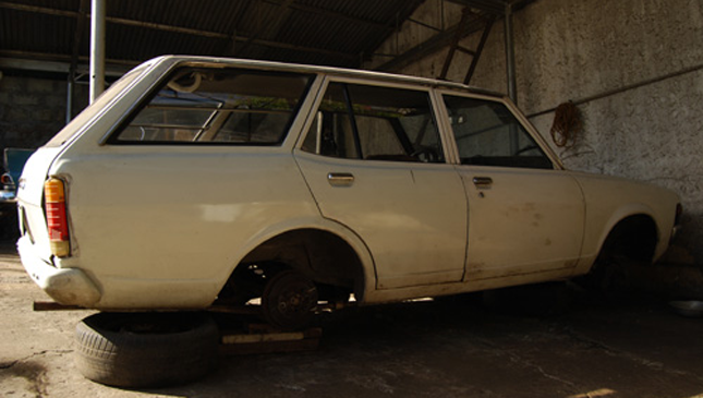

I totally know what you're feeling. When my dad passed away in 2003, he left behind a 1976 Mitsubishi Galant Wagon; a car that he loved so much. He drove it from the day he bought it brand-new in 1976, until the day he left us. The car sat for five years before I gathered the courage and saved up the funds to begin work on it.
It wasn’t an easy road. The wagon ended up going to three different shops before I was happy with the work done. You may have to backtrack a bit but the entire process was documented in this post. The wagon is fully restored now, and driving it brings me so much joy.
