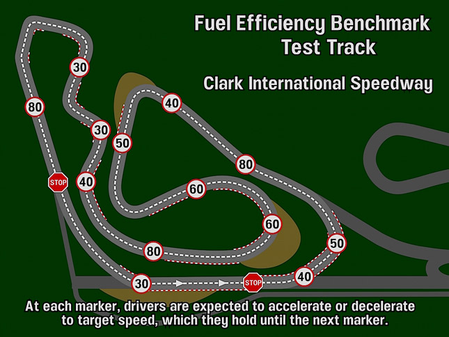

Instead, CAGI and SpeedLab mapped out a closed-course test loop at Clark International Speedway that simulated typical urban traffic conditions. The resulting loop--with the driver given a target lap time with target speeds to meet rather than attempting the fastest lap possible--was found to be consistent with the fuel consumption profile created by the same car, driven in the same manner, in typical urban traffic, as of 2010. Here, testing was carried out with a single test vehicle over two days.

Thus armed, CAGI carried out the first Fuel Efficiency Benchmark test at Clark International Speedway in 2013, evaluating 19 cars from eight participating car brands--BYD, Chevrolet, Ford, Foton, Kia, Mazda, Mitsubishi and Toyota--with logistical support from Chevron/Caltex and a stable of professional race drivers led by Formula 3 champion Pepon Marave. Race car drivers were employed in order to ensure consistency in both time and speed over the 100km test. The test was conducted at Clark International Speedway's East Course, with drivers asked to hold set speeds of 30-80kph in different sections of the track, with specified acceleration rates and braking zones. Two stops were included in the cycle to simulate traffic stops. The drivers were required to accelerate briskly up to speed in the higher speed zones, and to maintain a steady 30kph at high revs in the lower gears down the main straight. This was definitely not an eco-run type of test.
