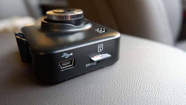

And speaking of SD cards, as we said, not all dashcams will support 64GB or 128GB ones. Cheaper ones will usually support up 16GB or 32GB of storage, so don't splurge on a high capacity SD card before buying a unit.

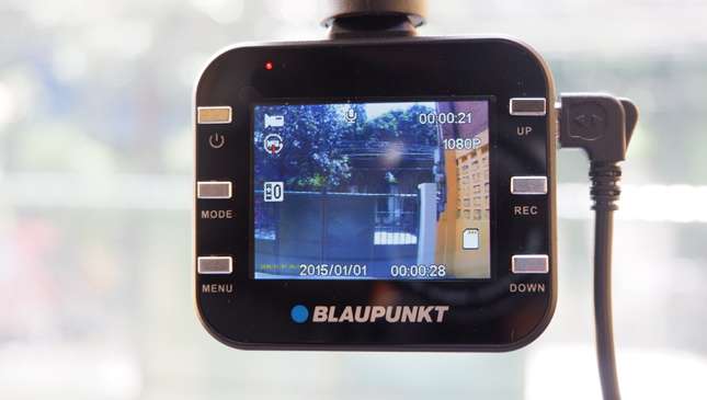

2) Be familiar with recording settings. Different models offer different recording settings and levels of quality. If your only reason for purchasing a dash cam is a little extra surety on the road, you can lay off 1080p 1920x1080 full HD recording and opt for something less, such as 720p which should still be clear enough for you to read license plates and road signs.

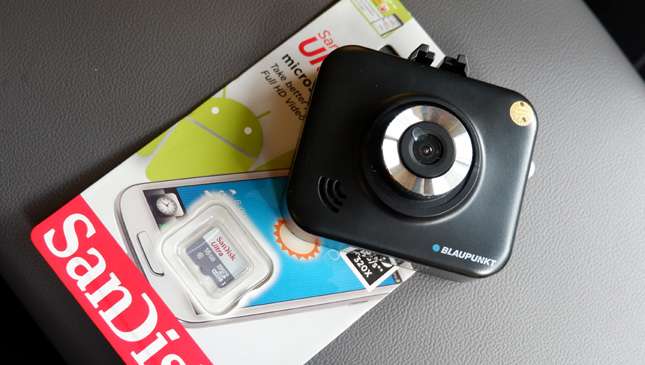

You can also set your product to record in loops of different length. The one you're seeing in the photos, the Blaupunkt 2.0 FHD, can record in 30-second, one-minute, or two-minute loops. If your unit features a date stamp in recording, do turn this setting on as it will come in handy in case of an accident. And if you'd like to have night recordings come out brighter, you can increase your dash cam's exposure settings. The drawback here is that it will sacrifice quality and increase noise.

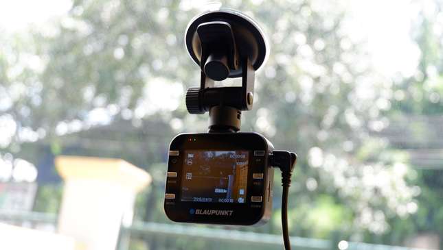

3) Make sure it's set up properly. Usually dash cams will come with either adhesive or suction mounts. We know it's tempting to opt for the adhesive and simply attach the unit to your dashboard to avoid that pesky power cord hanging about, but setting it up on your windshield is ideal as this offers a much better viewing angle.

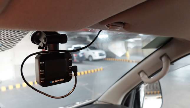

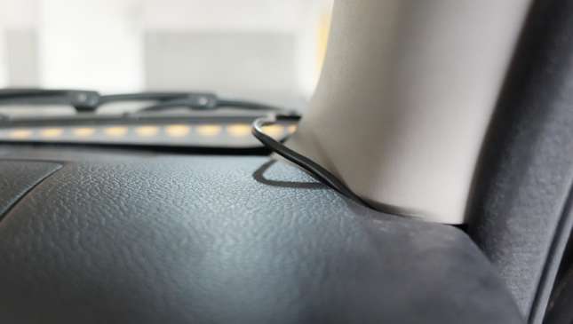

If you find that the dash cam's cable is too much of a distraction, you may want to make the effort to hide it by running it across the ceiling, the passenger side of the cabin, and underneath your floor mat. You can use thin electrical tape, cable clips, or you can even tuck it in between the headliner. This YouTube clip might help:
A few more things: NEVER place the dashcam where it might obstruct airbag deployment, do not use an adhesive mount on tinted glass as this may lead to damage, and know your unit's recommended operating temperature. Also, make sure to check if the time and date is correct after setting up.
