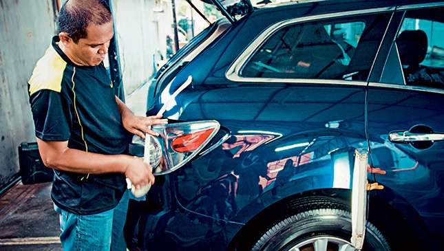

We witness how paintless dent repair is done

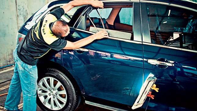

One solution is paintless dent repair. We visited a shop in QC that specializes in this, and they demonstrated how they make these dings disappear. It is a method that requires specialized tools, and it also involves some ingenuity. It’s more practical and affordable, too.
Seeing it done is like witnessing magic. Here are a few things to remember if you intend to have this type of service done to your ride.

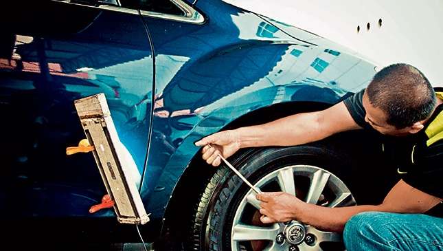

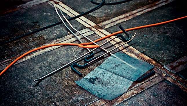

*A light source that can be mounted to the car body

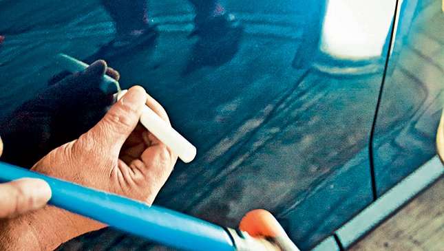

*Specialized pry bars, clamps and hammers

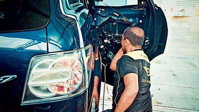

*Tools for removing lights, interior door panels, and splash guards

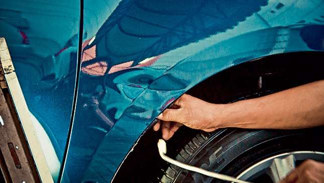

*Access to the panel is the only limitation. If a panel has a doublewall, or if there are support beams, it may be difficult to access the dent from behind.
*Every panel and every car is different. Sometimes you have to remove body trim to reach behind the dent.
*The tools are very specialized and have different purposes. Still, only skilled hands can do this job properly.
*A technician needs a special touch, and he needs a way to access the dents.
*The roof is difficult because the headliner has to be removed. The hood may pose problems as well, if the dent is behind the crossbars. But there are ways to get in.
