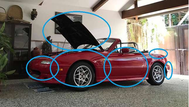

Encircled in the photo below are all of the panels that have been changed to carbon fiber.

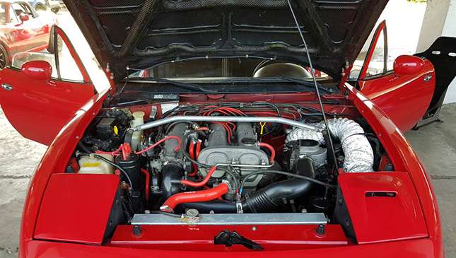

In the photo above you can see the exposed weave of the carbon fiber hood.
