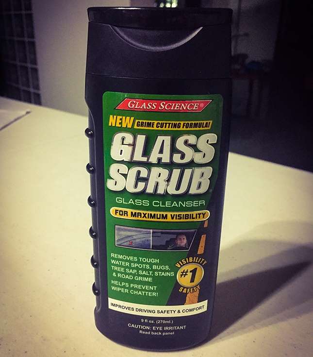

My product of choice was Glass Science Glass Scrub (initially designed for stripping your glass of stubborn stains, marks and grime). It's abrasive enough to slowly cut away at the surface when rubbed in long enough sans marring.
Working a small section at a time with my index and middle finger wrapped with a damp microfiber cloth, I made my forearm and hand mimic the rotational motion of a polisher, maintaining even pressure throughout as I applied minute amounts of the product at a time while occasionally misting the windshield with distilled water using a spray bottle. You must not allow product or treated surface to dry while doing so as this may result in very fine scratches visible under bright light.
After three long days of exhausting scratch-removing, patience and a near-empty bottle of Glass Scrub, I was quite pleased with the results. Unfortunately, I never trained myself to be ambidextrous so I ended up with a leaner, more ripped right arm!
