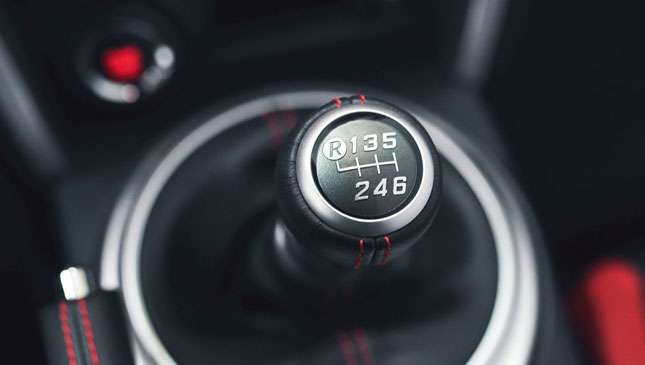

4) Make kadyot. With your assistant ready to push your car from behind, make sure to hold your steering wheel as you step on the clutch and brake pedal, shift the stick into second gear, and release the handbrake as you cue your pusher to propel the car forward. The ignition should be in the 'on' position. The reason why you’re in second gear is to prevent damage to your transmission as jump-starting involves getting the car to start while in motion at a speed that’s in tune with that gear. It is imperative to make sure nothing’s in the way of your car and you have ample runway ahead (around 50m at least).
5) Execution is the tricky part. Keeping your left foot down on the clutch, release your right foot from the brake pedal and move it over to the accelerator pedal. As you gain momentum (anywhere between 10-15kph), release the clutch, engage the accelerator, and twist the ignition. Twisting the ignition will help start the engine, especially if you have limited forward space. Otherwise, releasing the clutch is fine. Again, ample space is a must. The faster you go, you up the odds for a successful jumpstart. Oftentimes, this takes some practice and fine-tuning, aside from the human power your volunteers provide, but eventually you’ll feel proficient enough to get it on the first go.
