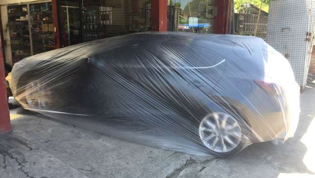

Note that a professional paint shop usually covers the newly-finished car to protect and prevent it from gathering dust, possible overspray and other contaminants. When we say cover, we don't mean putting cardboard panels or newspaper over your car. We're talking about an automotive wrap that allows air between the film and your vehicle’s surface to protect it from the external environment. That said, be sure to check the protocols of a paint shop regarding how they handle everything from ingress to releasing before signing up for the service. Regret is the last thing anyone wants to feel.
