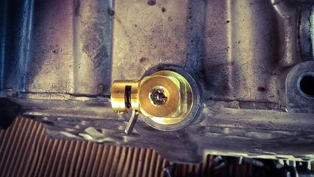

Whether it be online or from a reputable shop, chances are you'll be able to get your oil and parts like oil filters or drain plug gaskets for a significantly cheaper price than from the dealership. You may even get high-performance lubricants/parts that could be equal to or slightly cheaper than the original. Instead of using a standard oil drain plug, you can purchase a Fumoto oil drain valve that makes for an easier, leak-free outcome each time.
It pays to look around because bargains can be found online. Just make sure you have your specified part numbers with you for cross-referencing.

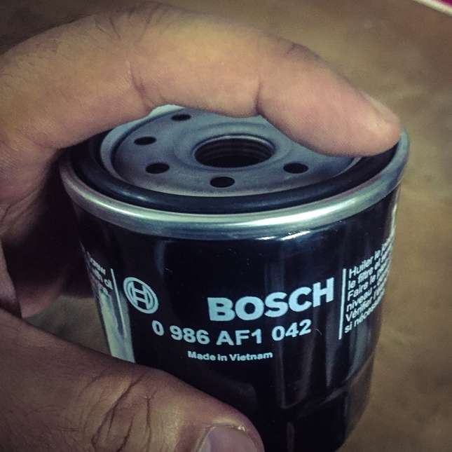

Inspect everything from draining, gasket replacement, how the oil filter is screwed on (should go on smoothly and never forced) down to the level of the oil on your dipstick. Before installing the new oil filter, dab a coat of fresh oil onto its gasket. It must be hand-tightened only.
