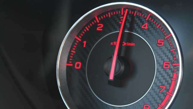

As racing coach Ross Bentley explains in his book Ultimate Speed Secrets: The Complete Guide to High-Performance and Race Driving, smooth downshifts happen when the engine revs are increased by a slight tap of the accelarator, otherwise known as 'blipping.' Doing this matches the engine's rpm to the rpm of the driven wheels.
So, how do you downshift smoothly without throwing your car off-balance? There's a few ways to do it, and one of the simpler ones is known as rev-matching. This simple technique ensures that your car doesn't jerk when you shift and allows you to maintain your current speed while keeping your engine within the optimum power band. Here's how you do it:
1) Step on the clutch to disengage the engine from the wheels.
2) Move the shifter into your desired gear.
3) Blip the throttle with your right foot to increase engine speed.
4) Once you feel the revs have matched, slowly release the clutch and go back to accelerating. If you've done it right, there should be no jerk at all during the transition.
