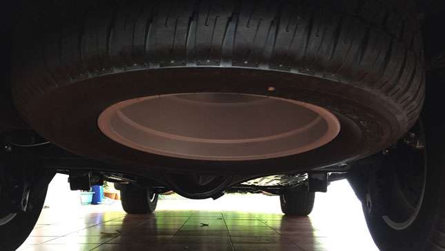

Usually, spare tires for sedans and hatches are stowed right under the lining of your trunk, and are protected from external forces. However, they can still suffer damage from humidity, moisture, and heat. For trucks, vans, and SUVs, the spare tire is commonly attached to the rear undercarriage and is highly exposed to the harsh external environment—regardless if it comes with a cover.

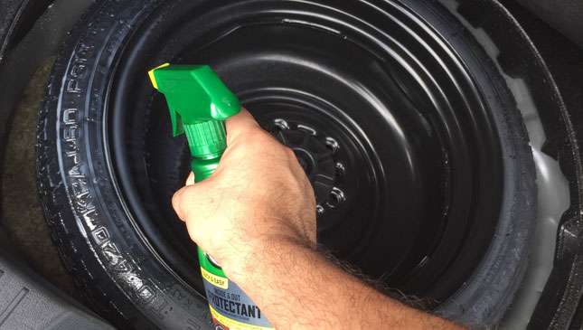

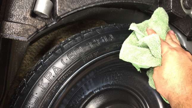

2) Detail your spare once every 1-2 months or immediately after use. Cleaning it allows you to check for abnormalities, cracking, and spotting leaks. Use a quality protectant or lotion with UV protection to prolong the life of the rubber and prevent dry rotting or cracking.
3) To check for leaks, use a pressure gauge and see whether your spare is able to hold its recommended air pressure rating. Add air when necessary.
Using a spray bottle with water/detailer/protectant, liberally wet areas around the lips of the tire (area attached to the rim) to see if you can spot any air escaping. Bubbling is a giveaway when a poor seal or puncture is present. Have it fixed or replaced immediately!
Don't forget to do a leak test on the air valve by drowning the inlet with water to inspect for bubbling as well.
4) For spares usually mounted underneath vehicles, check the mechanism that lowers the tire including the cable and retainer piece. As a preventive measure, spray these parts with anti-corrosive as they tend to easily rust. Oftentimes, the mechanism comes with a lock and keyhole where your ignition or designated key fits right in. That needs regular lubrication as well.
I've seen neglected locks that won't budge open due to severe corrosion. Despite having a perfectly functional spare, being unable to access it just makes it useless, wouldn't you say?
