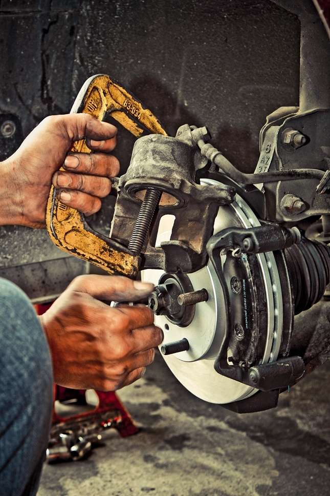

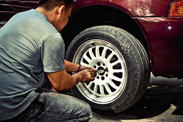

1) Loosen the lug nuts and raise the vehicle with a lift or jack. Remove the wheel and place it under the car for added safety. Find the bolts that hold the caliper in place and loosen them. Remove the old brake pads, and then lift the caliper from the rotor. Do not let the heavy caliper dangle from the brake line. Find a way to support it.

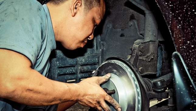

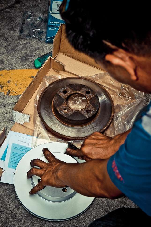

2) Sometimes you can just pull the rotor off from the wheel hub, but if it is stuck, you can use a hammer to loosen it. Strike the center, but use a buffer. Don’t be afraid to use force. If the rotor is held in place at the hub with a cotter pin, you might have to remove this as well.

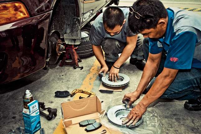

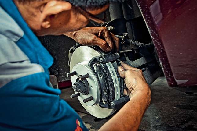

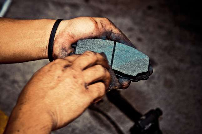

3) Before fitting the new rotor, the mechanics at Supreme Motor suggest using sand paper to remove the protective coating. They also sand down the new brake pads to make sure that they bite properly. After placing the rotor on the hub, use a clamp to press in the caliper pistons, position the new brake pads, and then bolt the assembly back in. Now, bleed the brakes. Wait a while for braking force to return. You may need to drive a few kilometers before braking force returns to normal.

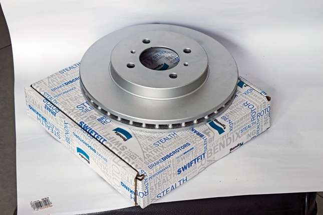

*Make sure that the Bendix rotor will fit by checking that it has the right size and has the proper PCD measurement for your car.

*Because Bendix is used in OE applications, you can be sure that it carries the rotor size for your car.
