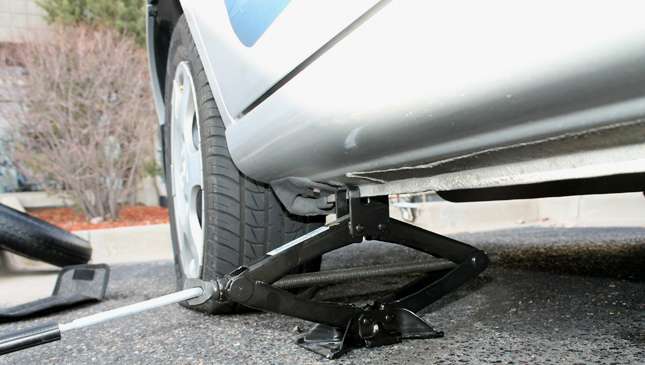

Some spares are dedicated spare tires, like space saver spare tires. These tires are usually much smaller and thinner than the ones mounted on your car. Space saver spare tires should never be used for long distances. They should only be used to get you from where you got a flat to the nearest repair shop to have your tire fixed.
Continue reading below ↓
However, if your spare tire is the same size as the ones mounted on your car, this is most likely not a space saver spare. Hence, you can use it for long distances assuming that it is in good shape. You can check out this article for more information on the size of spare wheels.
