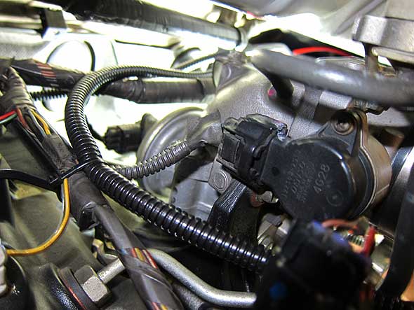

I read in car blogs and forums that one cause of this sign lighting up is a dirty EGR valve. I want to clean this valve myself, but I don't know where this valve located. I hope you can provide pictures.

To be able to truly address the problem you would need to know what's causing the light to come on. Perhaps it really is the EGR valve mechanism that's causing the problem, but then again perhaps not. I've taken a look at where the EGR valve is located on the Innova. To get to it would require dismantling the throttle body and parts of the intake system.
EGR in a Toyota Innova
