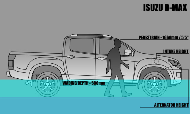

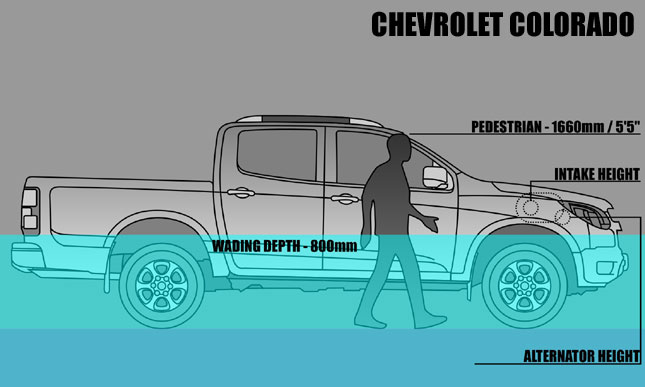

1. Find out your vehicle's rated wading depth, and determine why it's rated that way. Water entering the air intake is not the only danger to your vehicle. A vehicle's rated wading depth takes into account electrical, mechanical and electronic components that might be damaged in a water crossing, as well as how well sealed the cabin is from water intrusion. For example, the Chevrolet Colorado and the Isuzu D-Max have identical intake heights, but different rated wading depths. The former's wading depth is 800mm, while the latter's is 500mm.
Note that despite the high intake placement and relatively high alternator mounting, the D-Max is not rated to wade in water that comes up over its doors. While it will most likely survive wading through higher floods with a snorkel, better door seals and waterproofing might be a good idea if you want to do this regularly.

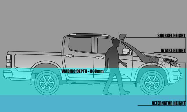

2. Find out if there are systems available for your vehicle. The easiest way to ensure a perfect snorkel fit is to buy one made specifically for your vehicle. While it is possible to customize a snorkel for vehicles where no ready-made one is available, it is an involved and costly process, and you may need to change your internal air-intake assembly to make one fit. Most commercially available snorkels are specifically designed to fit snugly against the bodywork. These ship with gaskets and seals to prevent leaks. They're also sized to bolt onto the bodywork where your standard air intake sits.
3. Don't skimp on quality. Cheap unbranded snorkels may look the same as the real thing, but sub-par plastic quality means less resistance to UV damage and small impacts. Original snorkels are made with thicker, tougher plastic to withstand the rigors of off-roading. Original snorkels are also "tuned" for the breathing requirements and capacity of the engine. A wrong or generic snorkel can choke the engine at higher rpms. The hoses and the gaskets that come with cheap kits may also not be up to the task of surviving actual inundation in a flood.

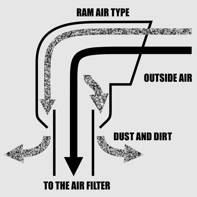

4. Decide what kind of system you want. There are generally two types of heads for commercial snorkel systems. The most common type is the ram type. This uses a forward facing duct into which air is "rammed" when the car is moving at speed. This high-speed airflow pushes any dirt and water to the back of the snorkel head, where it drains out through holes in the head or through a water dump valve before the air filter.
The other type is the cyclone or vortex type. In this one, tilted vanes inside the bowl-shaped head cause the air to swirl around inside. This swirling motion causes centrifugal force to push dust, dirt and water out to the sides of the bowl, where they're collected at the edges of the bowl. This is more effective in keeping your air filter clean, although it doesn't flow as well as the ram-type, which may affect power and fuel economy. As ever, your mileage may vary.
