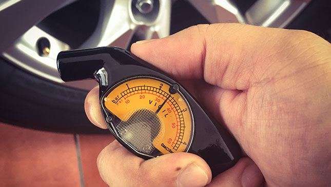

2. Maintaining proper air pressure. Not only is this for safety, it's also for maximizing the life of your tread and ensures better, even wear. Too soft and you could damage both tire and rim. Too hard, you increase the chances of getting punctured. Check your vehicle's manual for your recommended tire pressure.

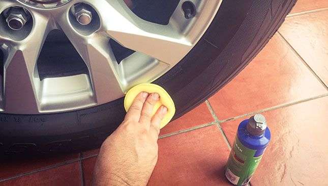

3. Applying tire lotions. There are quite a few options available off of retail shelves for tire lotions or tire shine. Choose one that adheres well to your sidewalls and doesn't create an unsightly mess on your side panels, gives UV protection, and promotes longer tire life. Looking guwapo is an added bonus!

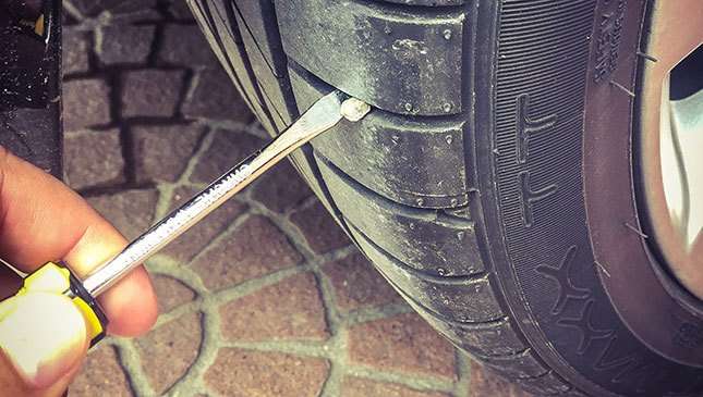

4. Inspect tread and clean regularly. It's customary for me to check my tires whenever I can. With a screwdriver or long-nose pliers, dislodge anything caught in your tire's treading. If something sharp has been pulled out, spray/drip some water to see if the puncture created a leak. It's really up to you if you wish to do the saliva test.

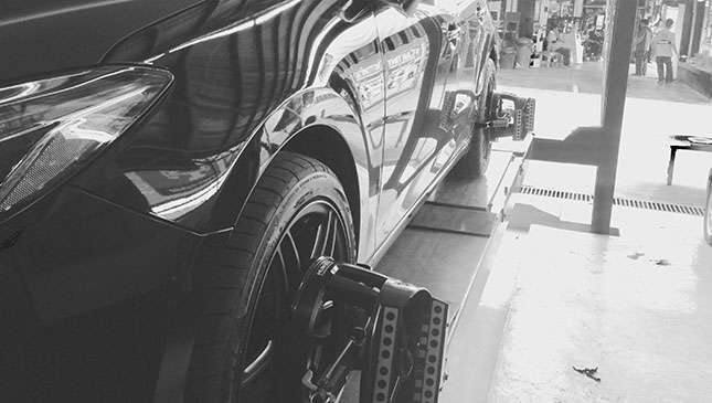

5. Rotation and alignment. Aside from maintaining proper air pressure, it is essential for regular alignment and rotation (every 10,000km) in prolonging your tires' health.

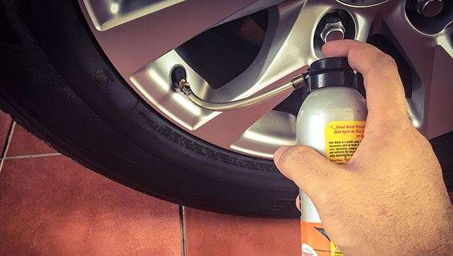

6. Investing in a tire repair kit/anti-flat solution. I discovered a few years ago that automotive shops carry quick-fix flat repair solutions—and they work! Basically, you just need to connect the can to your flat tire's air valve, and it will pump compressed air and a liquid solution to find the puncture and seal it until you are able to bring your car in for a professional patch-up. Make sure to follow instructions precisely. You'll thank yourself later when you're caught in a thunderstorm and realize you've got a flat to deal with.

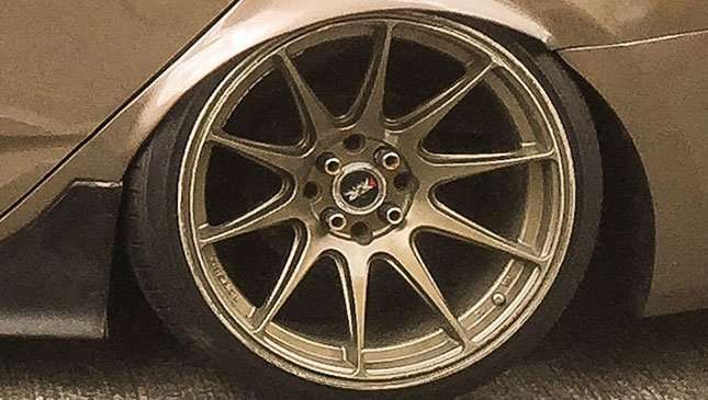

8. When selecting aftermarket wheels, go with an ideal fitment. When making our rides look and perform better, we usually invest in an upgraded set of wheels. It only truly becomes an "upgrade" when it doesn't hamper proper dynamics and camber settings; meaning zero fender, wheel liner, or suspension rubbing which can ruin both car and tires. Always check your stock wheels' offset/dimensions and use that as a reference when upgrading in order to stay within fitment parameters. Consult a professional when in doubt.
