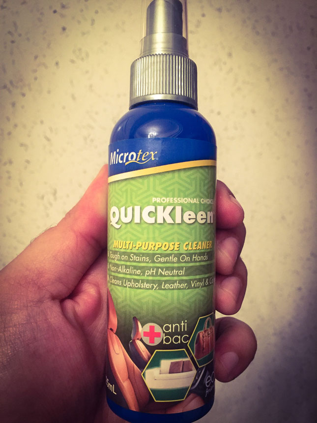

Microtex Quickleen - This is by far the most readily available, versatile, and effective solution for cleaning out dirt and stains from your sidings, seat upholstery, and ceiling lining. It's very affordable, too! All you'll need is two soft microfiber towels and a small soft-bristled toothbrush for stubborn stains like chocolate or blood. Even rust stains can be significantly reduced by the use of this. Make sure you are doing the work in a well-ventilated area as its vapors may irritate your eyes and sinuses. Using a face mask is highly recommended.
The rule of thumb when tackling stains is to work the area as gently as possible, especially with your ceiling's sensitive lining, so as to retain the fabric's look after treatment. All too often, folks tend to overwork an area to a point where the upholstery turns fluffy and ugly. I've always advised others to let the product do the work rather than you working the product. A degree of patience and finesse are always a must for optimal results.
To begin, you first vacuum the portion/s to be treated to remove loose dirt. Spray a generous amount of Quickleen over the stain and let it soak before attempting to dab and wipe with the first microfiber towel. After a minute or so, using the same microfiber towel, apply downward pressure onto the affected area in order to start loosening the stain from the fabric, bringing it outward followed by gently rubbing the towel from side to side over it. If using the towel isn't enough, then the soft-bristled toothbrush should help further. The solution will tend to foam up a bit. That's normal. Once you've seen an improvement, wipe off excess product with the dry microfiber towel and allow the area to dry. Repeat if necessary.
If you're dealing with ink stains from a pen or a marker, soak the area with 70% isopropyl alcohol and repeat the steps above with Quickleen. Just have some paper towels ready to soak it up before using Quickleen to finish it off.

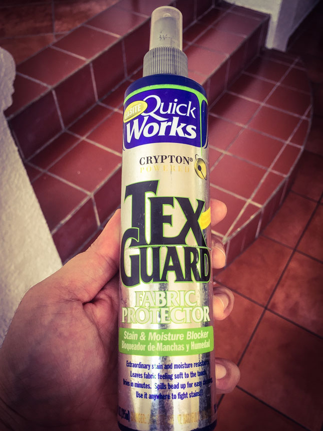

TexGuard Fabric Protector - After making your upholstery spotless, the smart thing to do is to create a protective barrier to repel future stains. TexGuard Fabric Protector is by far the best off-the-shelf product for the job. This is sold exclusively at Concorde outlets.
When my daughter was still a baby, she vomited on the backseat of my car which was lined with upholstery. Thankfully, I treated my seats with TexGuard prior to the incident and I was amazed that no gastric fluids seeped into the fabric, and I was able to wipe off the mess with no fuss at all. It has been a mainstay in my detailing arsenal since.
