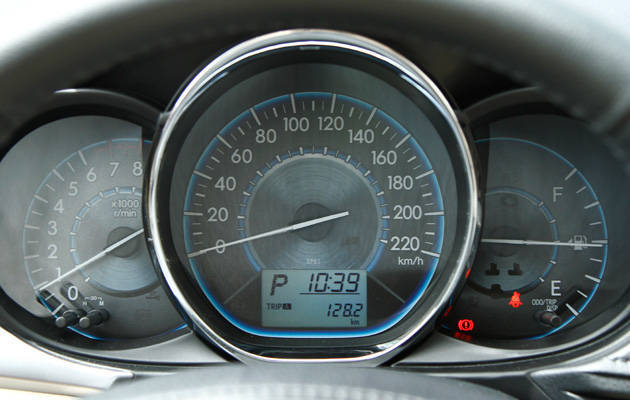

In our September issue, our staff writer Patrick Tadeo reported that he encountered less-than-stellar fuel economy with the all-new Toyota Vios 1.5 G equipped with automatic transmission. This was according to the vehicle's built-in fuel-consumption computer. He wrote: "After a week of city driving, the built-in fuel-consumption counter showed just 4.9km/L. It was only through some high-speed, late-night runs on the metro's major thoroughfares that we were able to bring it up to 6km/L."

Patrick tells me that he set the trip computer to zero when he received the unit, with the fuel-gauge needle pointing to the maximum level, but he doesn't recall what the kilometer reading was when he did so. He also tells me that the driving conditions he encountered were mostly heavy and slow stop-and-go traffic, a bane for the fuel economy of any vehicle. The conditions only eased up during the latter part of the test period.
Quite frankly, without knowing the exact specifics of how the fuel computer works on the test unit he had (which also happened to be an automatic variant, making it less economical than a manual-transmission variant), or the number of kilometers that had already been run by the car when he set the trip meter to zero, we won't really know for sure if the Toyota Vios 1.5 G will be a gas-guzzler or not over the long term. Another thing to consider is the fact that the test unit had only registered about 100km when Patrick got it. In general, most new vehicles will have slightly better fuel economy after logging a lot more kilometers than that.
What we do know is that at the time Patrick had it--in the condition he had it and under the driving conditions described above--the fuel computer readout should be correct.
