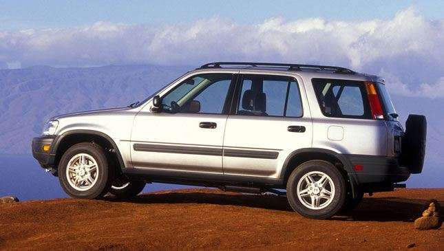

I hope you have time to read my message. I'm an old-car owner. We have a first-gen Honda CR-V with Real Time AWD and manual transmission, which we love. However, this sucker just eats up too much gas. We don't really have enough money to purchase a different car as we still have nine years on our home loan. I wonder if the CR-V is really like that. It's rated to have a 50L tank and I usually only get 265-280km on it in the city. By my computation, the fuel economy ranges from 4-4.4km/L. When I go to Baguio, a distance of about 260-270kms, I have an estimated 20 liters before the tank is empty.
I bought my CR-V pre-owned with around 75,000kms on it three years ago and it's at around 100,000 kms now. Two questions for you, sir:

If I recall correctly, a friend of mine who owned the same-generation Honda CR-V as you had a fuel consumption ratio of around 7.5km/L. This would've been around 16 or 17 years ago when he bought it new. His driving conditions were typically between 5-10kms and about three-eighths of that distance would’ve been with heavy traffic conditions for that time. The fuel economy he got was pretty good considering that the year 2000 CR-V has an EPA rating of around 9km/L city and approximately 11km/L elsewhere.
I suspect that you might be computing your fuel consumption incorrectly as the numbers don't quite match up. Consuming 30L (because you said you still had 20L left) for 265kms would come to about 8.3 km/L.

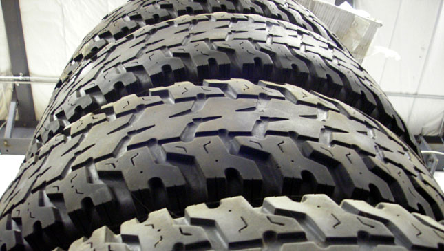

Remember to always keep your tires inflated according to manufacturer specs, as well as your alignment and camber settings in line. An improperly aligned steering system can add an additional 1km/L—more if it's badly cambered. Low tire pressure, on the other hand, can cost at least 0.5km/L extra.
