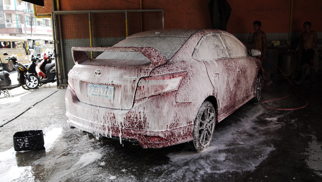

This time around, we used the TRD Sportivo Vios. Which is a Vios fitted with bodykit, a huge wing and big 17-inch wheels wrapped in Yokohama A-Drive R1 rubber. This made modification more challenging, but then, that should make the results more dramatic, right? Of course, first, we had to get the car cleaned.

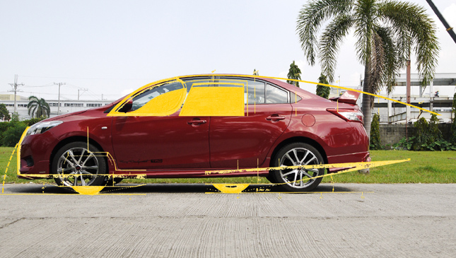

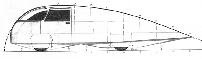

Aero ViosAerodynamic buffs often refer to the idealized teardrop-shaped template as one that provides the least drag. The template above comes from a 1930s aerodynamics study, and is shared online by noted aerodynamics enthusiast Phil Knox. Some of his work can be seen here.
Like many modern sedans, the Vios is subtly shaped to come as close to that ideal as possible while still maintaining a recognizable three-box profile. And here's how it compares to portions of the template. For a neat interactive tool using this template, you can go here.
Aero Vios

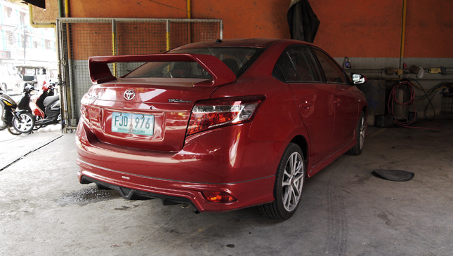

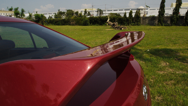

Last time, we discussed adding a rubber air dam. With the low-slung front lip, that would be difficult. Maybe next time! Note how that lip, the rear skirt and the rear wing conform to the ideal aerodynamic template. We doubt that rear wing is designed to provide performance-enhancing downforce. Rather, the small kick up at the end probably serves to clean up the turbulent air in the car's wake.
Aero Vios
Just like the little kick up in the trunk lip below it, it extends that smooth bubble of air behind the Vios, making it more streamlined without having to resort to an actual tail as seen in the template. Of course, it would be even more aerodynamic with a tail, but I'd need a lot of duct tape and board to make one.

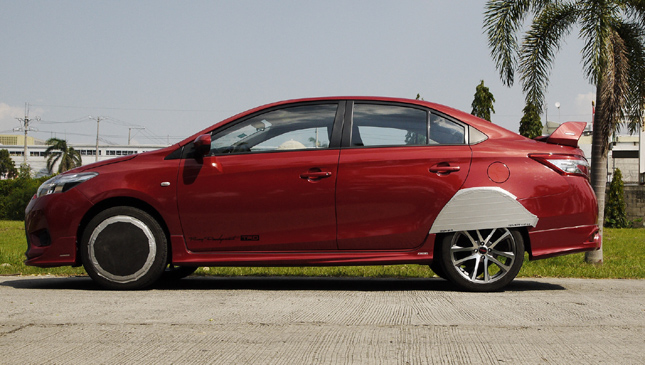

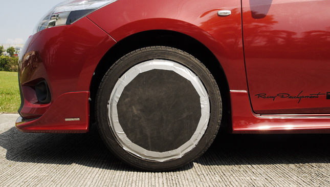

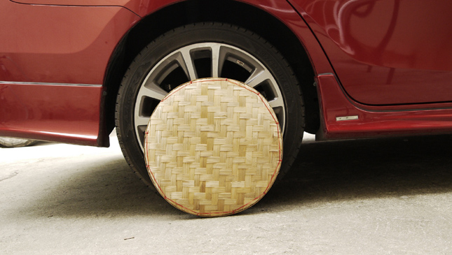

What we did add were some front wheel covers. Using a handy-dandy bilao, I measured out two 16-inch discs of rubber, which I then taped to the wheels with copious amounts of duct tape. Before we covered over the tire valve, we filled all four tires to 45 psi. This made the ride marginally stiffer, but it was worth a theoretical 2% extra efficiency. That's something we might want to test separately, on another date. What we can tell you now is that this pressure actually made the car track straighter on the highway. Worth trying if you like driving fast.
Aero Vios

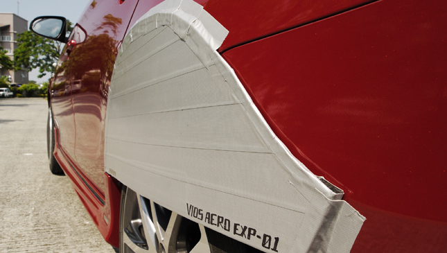

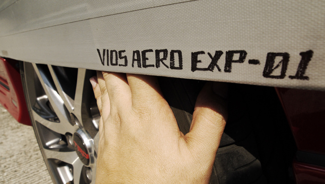

Some adjustments were required to make the rear wheel skirts fit around the wider 17-inch wheels. All that was needed was a small piece of rubber to lift the trailing edge. This 10mm-thick piece gave just enough clearance to put a finger's width between the tire and the skirt.
Aero Vios
Aero Vios
After a test run, no signs of rubbing were evident. Mission successful!
