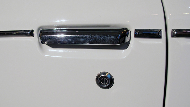

1. Gently knock on each body panel, including the roof. Why? Because this is how you can tell if there is putty or masilya hiding underneath that shiny paint job. A fresh panel sounds like a can when you tap on it gently. "Lata" is what we say when the panel is fresh. But if you get a sound that is like a dull thunk, there’s masilya under there. Should you walk away? Not necessarily, but at least you are aware that bodywork was probably done to repair a dent or some rust.
2. Open and close the doors. Do they feel light or heavy? Do they close solidly? Do the strikers and catchers do their job effortlessly? Are they in alignment? Again, a heavy-feeling door means that there might be masilya under the paint. And if a door is not in alignment, it was probably hit at some point, and the repair wasn’t very good.
