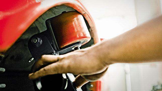

How to roll fenders with a wheel-arch reforming tool

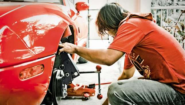

1) Park on a flat surface and put wheel chocks on for added safety. Lift the car with a jack and remove the wheel below the first fender that will be rolled. Use a jack stand to support the lower suspension arm because the hub has to remain at a level similar to when the tire is on. Remove any fender liner if necessary.

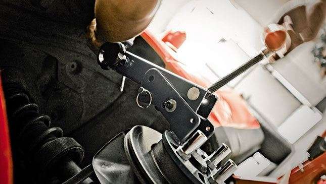

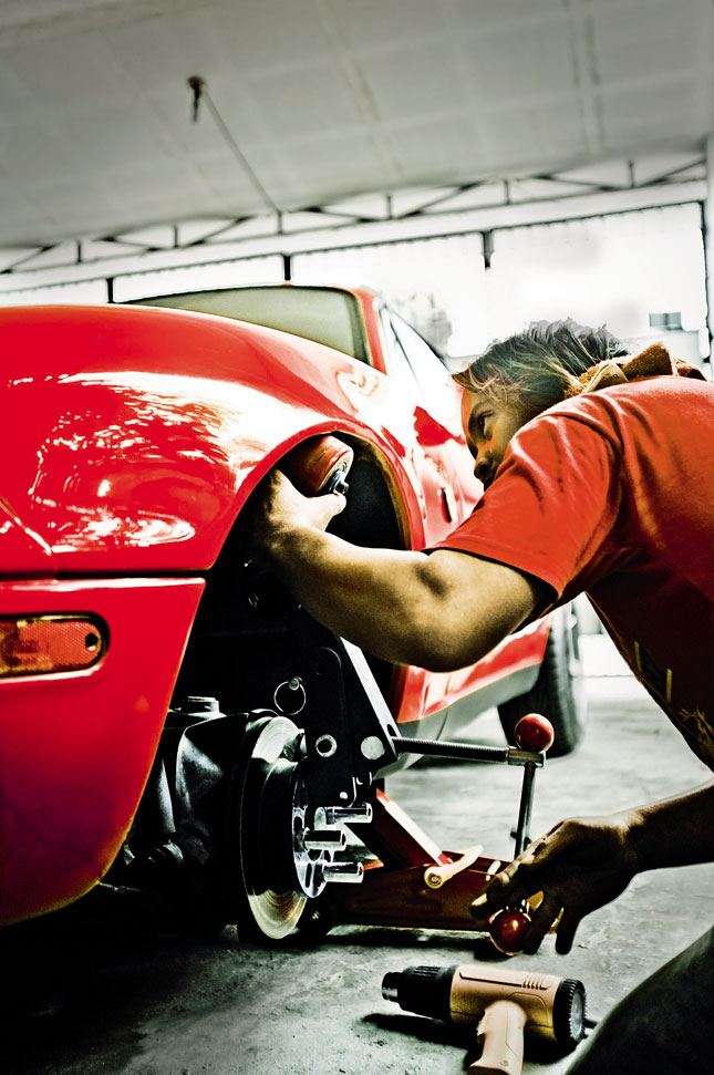

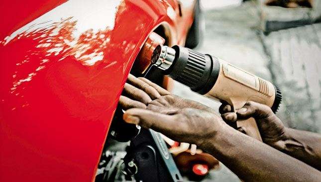

2) Attach the wheel-arch reforming tool to the hub. It fits on like a tire does. Tighten and secure the lug nuts using the same torque as you would when attaching a wheel. Now, adjust the tool so that it hits the fender lip at a mild angle first. Do not attempt an extreme roll right away. But before getting to work, you have to heat the fender first to keep the paint from cracking. Do not keep the gun pointed in one place for an extended period as this can cause the paint to bubble.

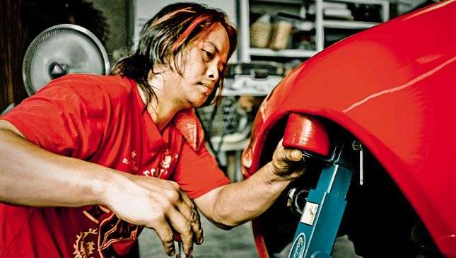

3) Roll the fender gradually and use common sense. Keep applying heat. Do a progressive roll. Pay attention and keep adjusting the angle, but only slightly. If more clearance is needed, push further in, but slowly. Are you done? Repeat this at each corner of your car and say goodbye to fender rub.
