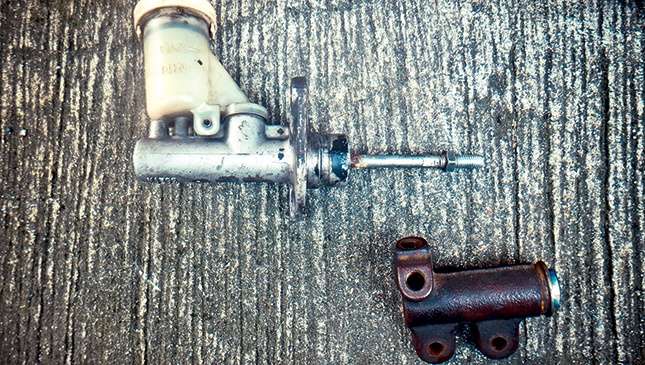

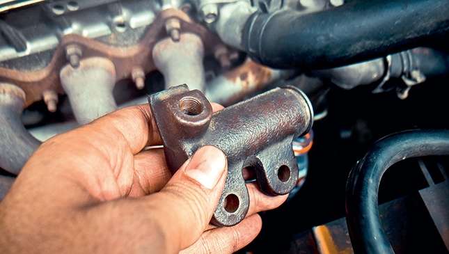

What is the color of the clutch fluid in the master cylinder reservoir? If it is dark and mucky, that’s a sign that it will fail very soon. Now, locate the clutch slave cylinder. This is usually positioned on the bell housing of the gearbox, near the clutch disc, pressure plate, and release bearing.
Undo the clutch slave first. Be delicate with the metal clutch line and fittings. You don’t want to damage any of the lines. Be prepared to catch any clutch fluid using a bottle of some sort. The fluid is filthy and black. Next, remove the clutch master.

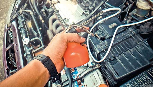

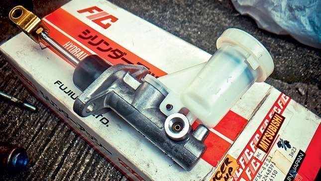

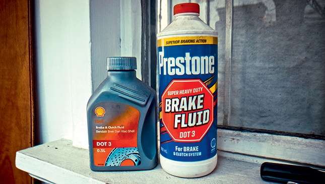

Flush the clutch line by pumping clean brake fluid into it. Use a clean oil can and a flexible hose. Now, install the master and slave cylinder but do not over tighten the fittings. Fill the reservoir with new brake fluid.

*Brake fluid is highly corrosive and can destroy paint. Work with care. Rinse off with water immediately if it gets on any painted panels.
*To increase the longevity of hydraulic parts, change the fluid once a year or when you notice discoloration.
