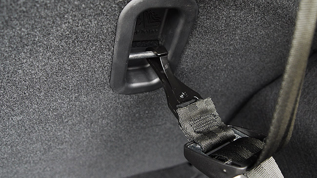

Isofix anchors consist of two lower loops per position to which the child seat can be fastened, as well as a top tether anchor for use when the child seat is placed in the forward-facing position.
How to properly mount Isofix child safety seats
Some cars have two top tether locations (above); others have three (below).

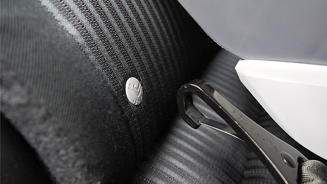

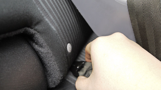

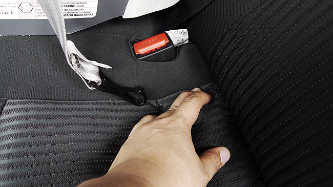

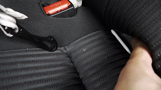

Once it's in position, locate the lower anchor points. These are usually marked by a little button or a small cloth tag with the word "Isofix." If you're not used to it, it can take a few tries to find the loop. Otherwise, it's pretty easy. It is the task of removing the clips that's difficult.

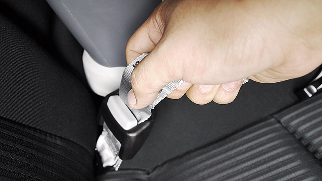

After securing both anchors, tighten the strap. When removing the seat, don't forget to loosen the strap again!

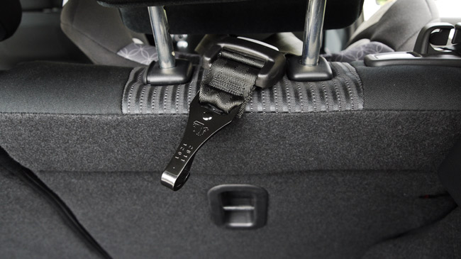

Next, attach the top tether. This part is pretty easy.

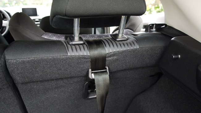

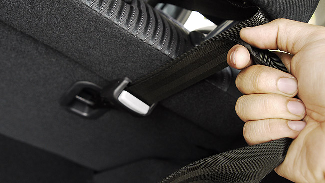

Thread the upper strap under the headrest, and clip it to the tether.
Then tighten the strap. Make sure the seat is centered.

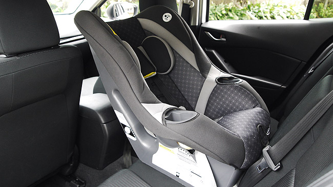

Installing the seat in rear-facing position is much easier, as this only involves the lower anchors.
The center of the rear bench is typically the safest place for your child seat.

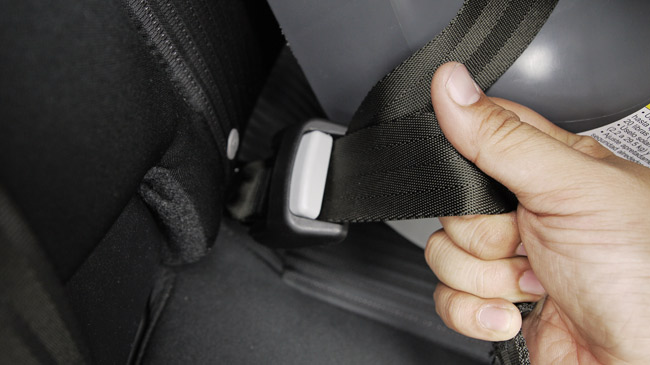

As before, locate the anchor points and latch the belt to them.
Again, pull the belts tight. And again, you may have to put some weight on the chair to get it to sit without wiggling.
