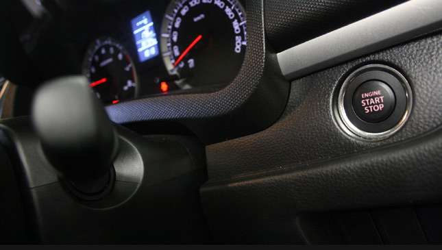

1) The ignition. On-off. On-off. As long as you’re not engaging the starter, you’re not hurting anything, right? But the drain on the battery from priming the fuel pump and electronics over and over again can take its toll on your battery. And, on a diesel with glow plugs, accidentally leaving the ignition on overnight can burn them out.
