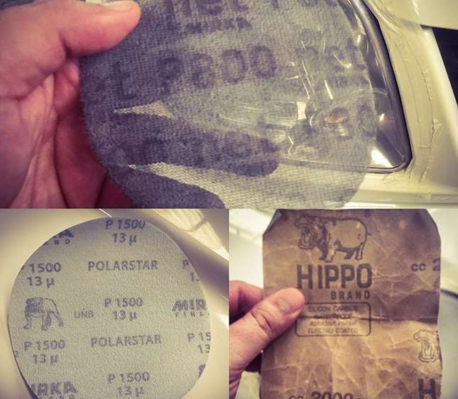

*Get yourself some sandpaper; 800 grit, 1,500 grit and 2,000 or 2,500 grit.

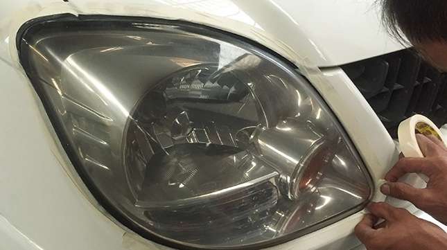

*Clean headlamps followed by taping its outline in order to protect the paint around it.

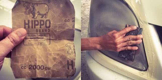

*Dry sand the surface of the headlamp using 800 grit sandpaper while strictly following a back and forth, left-to-right motion. This is to rid the surface of unwanted, oxidized plastic. The whole headlamp will be very hazy after you've completely done this. Don't worry, it's normal.
Continue reading below ↓

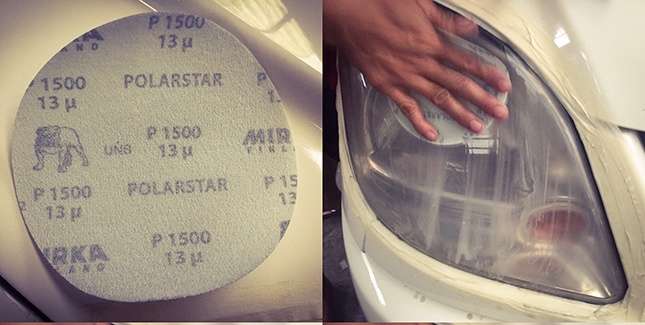

*The next step is to switch to 1,500 grit sandpaper. This time, you'll be damp-sanding the surface by spraying a thin layer of water over the headlamp and sandpaper. Instead of sanding in a side-to-side manner, you'll be executing up and down even strokes. Why? The sanding in the previous step left what is known as abrasion peaks. This switch in direction will flatten out those tiny peaks for a better finish later on.
*The last sanding process involves the use of 2,000 to 2,500 grit sandpaper. Follow procedure in the previous step but revert back to the left-to-right motion. When done right, you will witness a noticeable improvement in clarity. Once you've tackled the whole surface, you can already feel a huge difference in terms of surface smoothness as opposed to the roughness it had prior to initial treatment.

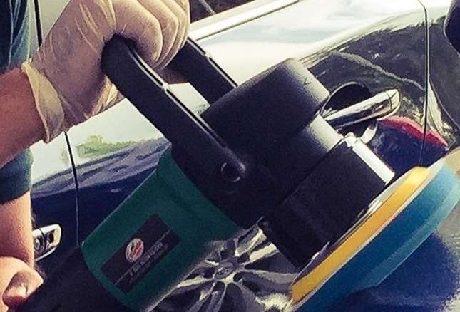

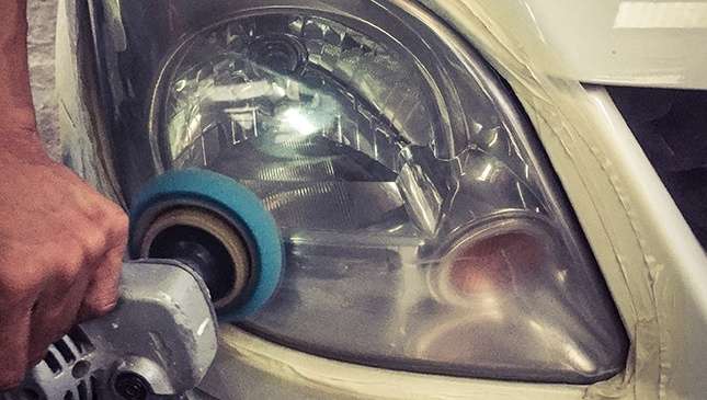

*Now comes the finishing process of polishing. If you have the convenience of owning or being able to borrow a dual-action polisher, then, by all means, use it. Just in case you have no experience in using one, ask a pro or simply search online for demo videos. In the circumstance that it isn't available, old-fashioned handwork with a quality microfiber towel should do the trick, but will require a lot of patience and endurance—a more rewarding approach, in my opinion.
As much as possible, use a decent, two-step compound (medium and fine cut) along with the polisher. You can also find off-the-shelf compounds that combine the effects of the two-step process in a single bottle. From personal experience, the two-step technique will always yield more refined results.
If you end up doing it by hand, do a small section of the surface at a time moving in a circular manner using both index and middle fingers. Pace yourself as you proceed to ensure equal effort is given all throughout the headlamp. Depending on the severity of the correction needed, this may take a day or so to accomplish. Just think of it as quality time with your baby.

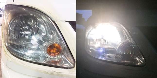

Once clarity has been restored, you'll want to protect your freshly rejuvenated headlights by applying a UV protection solution for headlamps available in the automotive section of almost all major retailers. This will prolong the results of your hard labor.
