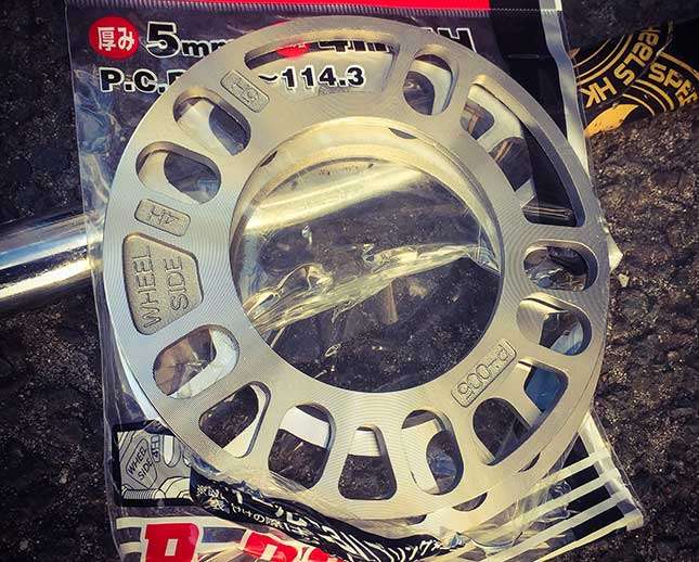

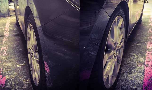

This round metal plate (usually made of aluminum alloy) with hub-centric and stud-sized holes is mounted between your hub and rim. It allows sunken wheels to stick out more, making it look more flush with the fenders to give your ride a sportier look.
For the benefit of performance, it widens your track (the parallel distance between your wheels) which improves handling/cornering. I will not bore you with a mathematical formula showing how much of a benefit it adds. Just remember that any positive effect the spacers add, regardless of how minimal, is still a very good thing.

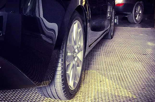

I recently installed a quality set of wheel spacers when I reverted to OEM wheels. Going the conservative route, I went with 5mm spacers. Though it may not sound like much, it added a total track width of 10mm to my front and rear wheels. I must say I was truly happy with the results, including a test run from Manila to La Union. My obsessive-compulsive nature noticed a slightly sharper response when I hit the winding roads between Rosario and Damortis.

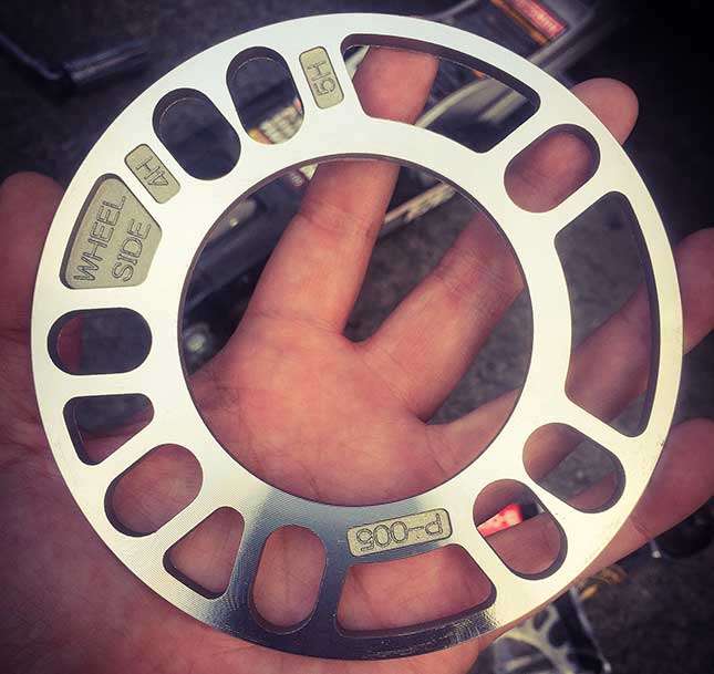

1. Choose a quality set. There should be no compromise here. You will find a lot of very affordable ones online, but these may crack when stressed. Saving three or four digits isn't worth the risk of losing safety. Get a set of branded ones (Japanese or US-made) from a reputable shop.

3. Select the right fitment. Always make sure that you pick the right spacer to fit your pitch circle diameter (PCD) and number of studs. There's a decent selection of universal spacers out there, but if you can acquire a precise fitment, then go with that. If your fitment is 114mm x 5 holes, make sure the spacer has those specs.

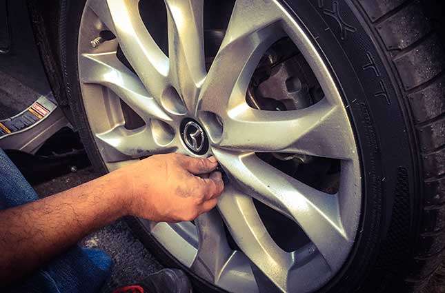

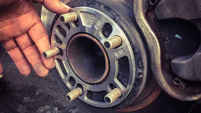

4. Carefully mount each wheel. Place the spacer flat against the hub before bolting on the wheel. If your spacers come with a ridged surface, that side should face outward. Place the first lug nut on the topmost stud but don't tighten until all lug nuts are in place. Make sure not to over-tighten the lugs as this may cause damage to the spacer or studs. In any case, it's always best to use a torque wrench.
