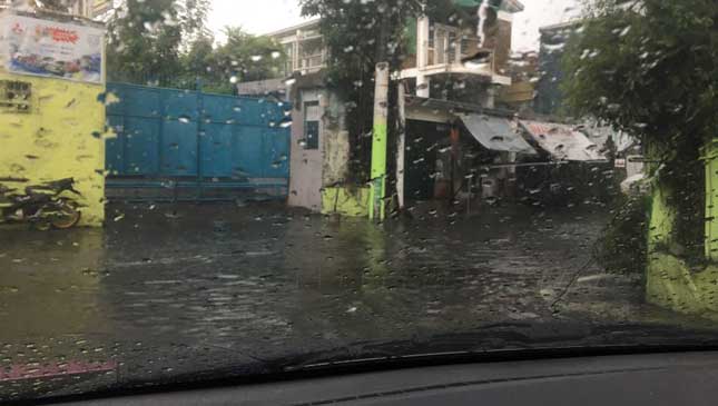

Flooded road in Metro Manila
Though most modern cars’ electrical connectors are more water resistant now, it’s not an absolute guarantee that moisture will not enter and cause issues like shorting. Inspect fuses in the fusebox if everything is intact. When a fuse is busted, locate the specific part by referencing the legend usually found on the fuse box cover. In addition, check your computer box to see if it took a dip. Wipe it with a clean towel to remove as much moisture as possible to hasten drying. Provided your fuses are okay, check all your external lights as well.
