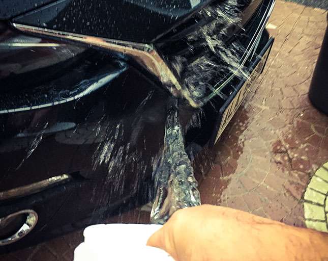

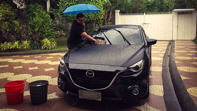

Let's start. If the downpour is heavy enough, you can do without the buckets (but it's always good to have a full bucket on standby) and just apply shampoo directly onto your wet microfiber mitt. Proceed to gently soap away. Of course, inspect mitt between soaping and squeeze out abrasive debris as the pouring rain aids you in rinsing.
If your vehicle is heavily soiled, the two-bucket method is still best so you can thoroughly rinse off your mitt from time to time and prevent scratching.
As always, begin from the roof of your car and work your way down to your side panels then wheels. This is actually quite relaxing as you won't break a sweat. At a laid-back pace, I can do my entire car in just 15 to 20 minutes.

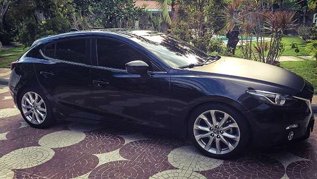

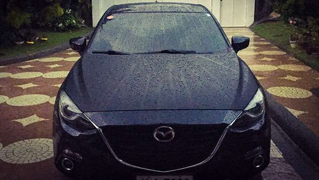

After soaping every square inch of your car's exterior, the downpour will take care of rinsing your vehicle and all you'll have to do is park in a ventilated, sheltered space such as an open garage and let it air dry. Yes, you read that right. Air dry.
Pure rainwater doesn't contain salts, minerals and other contaminants found in tap, so you won't have to worry about watermarks or unsightly stains. Note: You can use the collected rainwater for a more thorough rinse especially when the rain has abruptly stopped.
