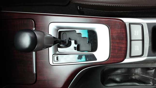

With the launch of the new Toyota Fortuner--with its more efficient 2.8-liter diesel engine and upgraded six-speed automatic transmission--we've been hearing (and receiving) some complaints about jerkiness or “shift shock” in the gearbox. This more commonly occurs when slowing down in Sport mode, as the transmission downshifts, but can also occur during upshifts or normal operation in other modes. Often happening at the 35kph shift point (and sometimes at 80kph), it is sometimes mild, sometimes annoying, and in some cases harsh.
Social-media groups consisting of owners both here and elsewhere in the ASEAN region have been abuzz with speculation as to the actual reason for this issue. Some suggest it's merely an electronic issue--something to do with the software algorithm controlling the shifts. Others think it's a lack of transmission fluid in the sealed "lifetime" automatic transmission. Or maybe a sticking torque-converter clutch.
Not all units are affected, but a number of Fortuner and Hilux owners have reported this issue. Dealers have been very receptive to these complaints, and solutions have ranged from resetting the ECU to altering idle speeds and replacing torque converters.
Continue reading below ↓
An increasingly common (and apparently permanent) solution seems to be a full transmission replacement. This solution appears to be effective and permanent, and owners who have had the replacement done have so far reported no recurrence of the issue.
